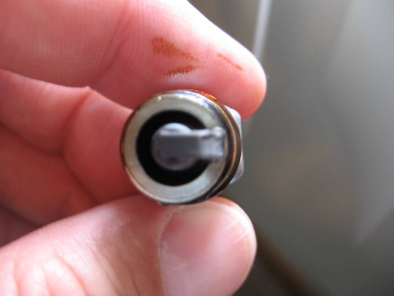

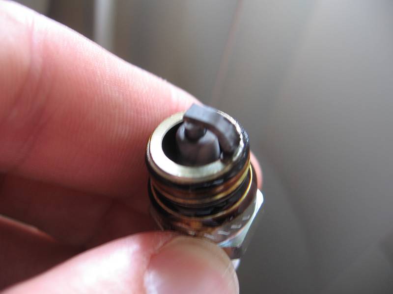

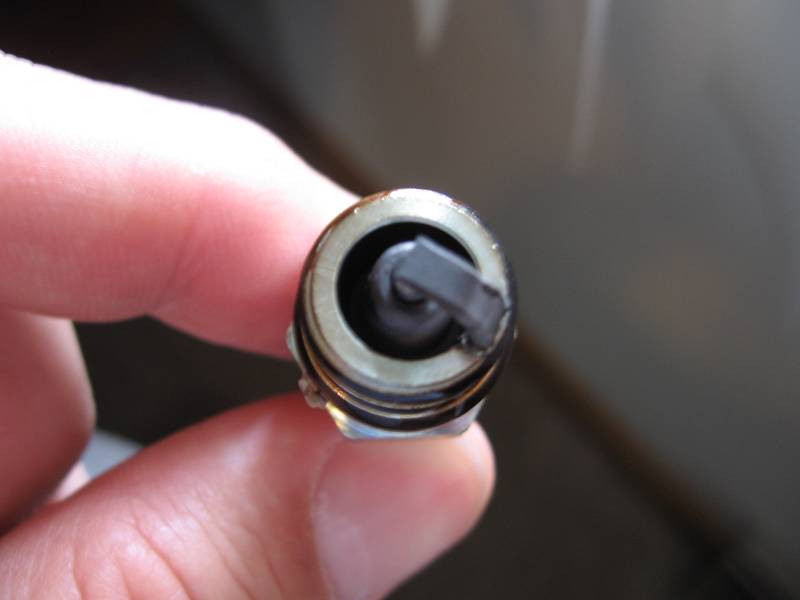

I'm pretty sure this will be unanimous. My ZDZ 50 NG quit while buzzing around at or near WOT for a few minutes. I thought it was due to a lean run. Check out the plug. It was never run after it quit up in the air (dead stick). I think it looks lean.

that is the cleanest plug i have ever seen out of a gas engine.i don't like to see mine any lighter in color than a dark gray,better yet a light tan in color.but i will put money on it though the reason it stop was due to a lean run.but i am no expert just a guy with a wrench and a hammer.

I also think it is lean, the last picture shows up that effect.

Yeah a clean plug is not good in this case. I think it's so clean because it was so lean. Not sure what made this engine go lean. It was running great and then all of a sudden this issue pops up. Think I may have an air leak in the engine some where?

A very short lean run due to some mishap before the engine quits will be impossible to tell from the plug. Let guesswork be guesswork. You need a decent run to get a good plug reading.

The best way to tell is replace the plug and fire the engine. Run it to full throttle for about 1 minute and cut the ignition at WOT. Then check the plug to determine your tune.

From what I can see from the pictures, that plug does not look like the engine has been running lean.

I think it looks lean. If the color doesn't show up well in the pic's, I can tell you that it's a light gray and should be more of a light brown or dark tan. The plane was unloading a lot due to high air speed, I think it was running lean. I usually don't run WOT so I think that's why it showed up. Also I think possibly my fuel inlet was letting in air. I'll know next time I fly. I zip tied the fuel inlet so hopefully that makes the engine run more rich.
