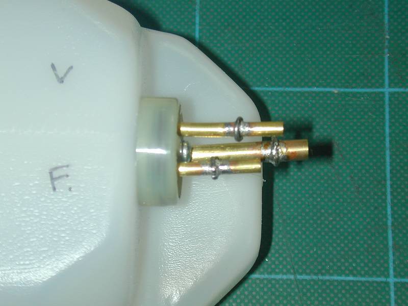

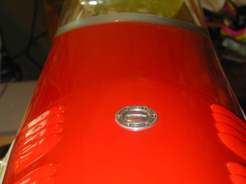

Barbs on the tubes out of the tank can be made by soldering a small piece of paper clip wire to the tube, make sure you do the clunk inside the tank as well. Also make sure you don't leave behind any sharp edges that would cut through the tube.
Vent line needs to go over the top of the tank before exiting the fus to stop fuel from syphoning out in manouvres.
I personnally don't like the T connection in the feed line as it introduces another joint that could suck in air, I have also found that the commecially avilable fill valve sealing rings break up in time and allow debris into the carb with obvious results, I always use a dedicated filler.
Mike

Old 07-10-2008 | 07:47 AM
Joined: May 2002
Posts: 6,852
Received 33 Likes on 32 Posts
From: Mandeville, JAMAICA
Default RE: gas engine G-26 help
As they say, a picture is worth a thousand words as those say it all. I'm with Mike on the T connection issue, as I've done that and got burned. Now I use a dedicated third line for filling and emptying the tank.
