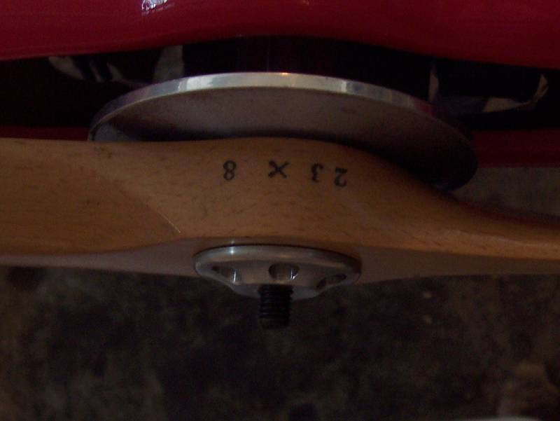

Here is what I have. I screwed the stud in all of the way (finger tight). I have 5/16" of thread showing after installing the spinner backplate, prop, and prop washer.
Is this what the manual is trying to tell me to have at least 7/16"?
Do I put silicone on the shaft?
Joined: Oct 2004
Posts: 1,416
From: Altaville,
CA
I would want to be able to double nut the prop on so I would get a longer stud. I replaced mine (115) with a titanium stud also from these guys. http://www.yoyodyneti.com/ The HT Copper silicone is what I use, so far so good.

Not much popping or backfiring, unless an ignition goes bad. The double nutting helps a bit to retain position as the wood of the prop compresses. I'd be willing to bet the 50cc came with two nuts.
As fas as where the shoulder engages, the stud needs to be screwed in far enough to get plenty of threads gripping inside the engine's crankshaft. By shoulder I guess he means on the crankshafts tapered end that the hub mounts on, and the stud screws into. Unless you remove the hub you can only guess where that is.
