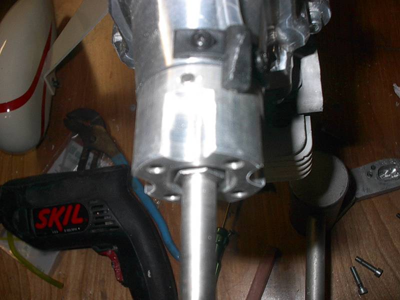

I am still working on trying to get this engine to start. I tried replacing the battery and that made no difference so I assume the only two things it could be are the timing or the box. I decided to go ahead and try to check the timing. I have been reading up on that but I'm still not exactly sure how to check it or how I would change it even if it is wrong.
When I was looking at it I did notice something that seemes a bit strange to me. When I set the piston to TDC the magnet is quite a ways past the pickup. I don't claim to know a whole lot about engines but it seems that the plug would be firing pretty early.
Here is a picture of what I am talking about. In the picture the piston is at TDC. Is that the way it is supposed to be?

ORIGINAL: ply2win
The timing is set at 28-30 deg before top dead center and the ignition retards it to around 3-5 deg before top dead center, The picture looks to be about right.
Could be off a couple deg but the engine still should start.

If I understand what you are saying that means that the plug should fire after the magnet passes the sensor. When I hook up the plug and spin the prop around the plug is firing exactly when the sensor is passed and not after.
Another strange thing I noticed is that if I spin the prop around counter-clockwise it fires right at the sensor but if I just keep spinning it a little farther and then stop and spin it back clockwise the plug will fire before it gets back around to the magnet.

When you flip the engine to start the ignitions does different that when you turn it slow, There is a chip in the ignition that retards the timing about 25 deg and as the engine turns faster up to around half throttle the will advance the 25 deg.

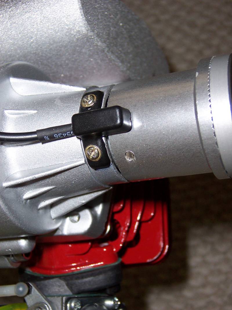

Here is a picture of a Area 51cc at top dead center with RCexl ignition runs great.
Milton
