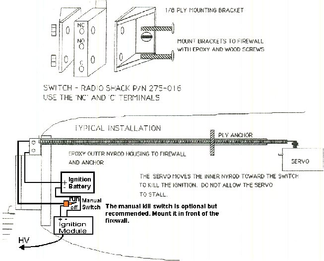

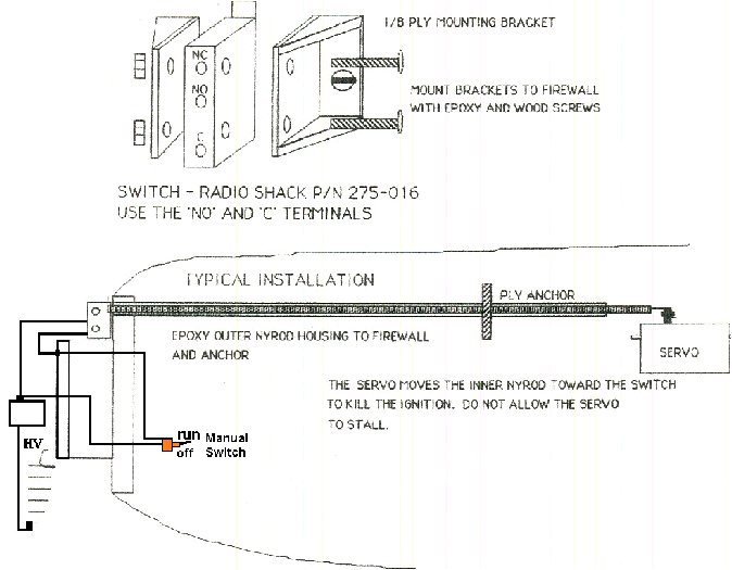

Here is a simple drawing of a kill switch setup for a magneto engine module like a G-38, G-45, or G-62.
Of course the micro switch is very desirable but optional. I personally like to use the idle stop screw because I don't want a very minor glitch stopping my engine when it is running near idle.

Here is a simple drawing of a kill switch for an external ignition module like a Brison or ZDZ.
