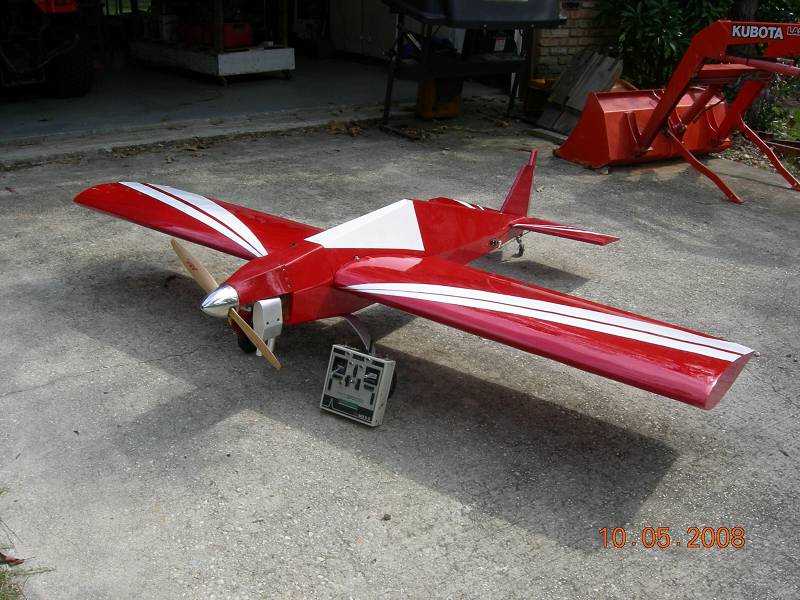

You are correct. I returned the module under warranty and it has been running great since the new module installed.
The engine has met all expectations with the new module.
I am flying a 17# Big Hots I call the Phoenix due to rising from the water of Katrina. (the parts were cut to build the hots and in a box on the floor. The house flooded,, the box floated wet all the parts and they all molded. I sanded cloroxed some, and made some new parts, the plans were totally ruined but enough there to get a idea on how to build the bird.
