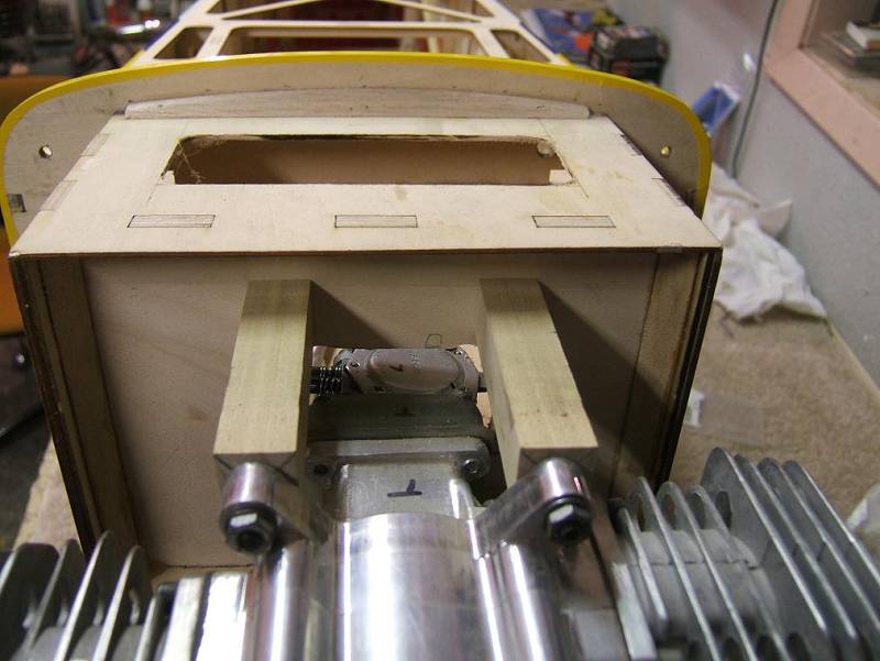

You don't need the manufacturer to provide a template. They don't know what engine you're going to use. Instructions themselves are pretty easy. Center the engine on the firewall where it will be when properly aligned with the cowl and drill 4 holes. First determine how long the engine mounts need to be. Be prepared to make your own.

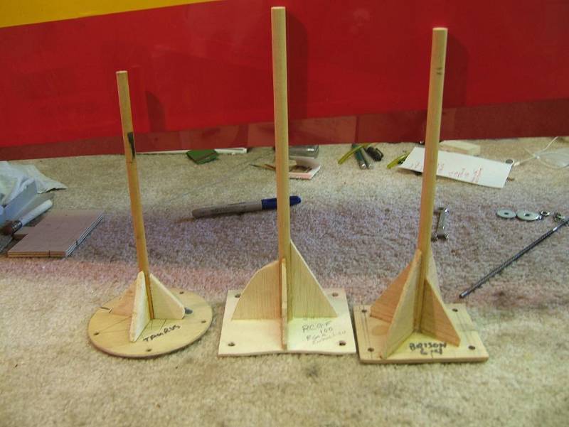

Below are engine templates for a Taurus 3.2, Brison 6.4, and a rear induction RCGF 100. For those that don't have table saws there's a picture of a tool you can pick up at any hardware store pretty cheap for making accurate cuts on the engine mount stock.
The wood engine mount standoffs here are 3/4" hardwood square stock available at lumber yards or hardware stores. Costs a couple of bucks. After cutting them to length, center drill them on a drill press. If you don't have a drill press find someone who does. Go slow and don't pressure the bit to prevent bending the drill. That's what makes for center holes that angle away from true center. After the standoffs are installed you can cut some 1/8" ply to connect (glue) the standoffs and make them as solid as the firewall. No need to glue them to the aircraft firewall unless you want to but that makes it a bit tough to change to another engine type at some later date. I prefer the structural rigidity that a "boxed" engine mount provides. No engine twist as you would have with individual standoffs. Nada, nyet, none! You can box the entire mount or simply add a sheet of ply to any pair of legs. No movement at all and much more secure than individual aluminum standoff legs.

Those templates you made are really AWESOME!!! Did you trace the template using the engine backplate?
I got to make me some of those.
Pretty much, yes. However, when you go back to my first post and read the added text you'll note that some engines will not let you "trace the backplate". RCGF is one of them, as is 3w, DA, and some others. For those you just need to be either be a little creative with some poster board or be real good at geometry. Hopefully you're real good at geometry
The nice thing about the templates using the long dowels is that no matter what the stand off distance is between the engine and firewall, the prop shaft will be properly centered in the cowl ring if the dowel was centered when you marked the mounting holes on the template. So a little extra time spent making sure the template was accurately made will provide for excellent engine mounting every time.
