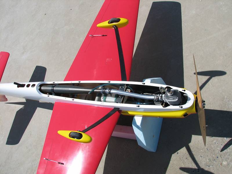

You can't reinvent tuned resonance -
there are a million tuned gadgets for two strokes but to get smooth throttable POWER you need some volume
My ZDZ40 uses a carbon fibre pipe with the baffle at 28" from piston face
Makes no sense ,right?
Actually i does if you do some hands on comparisons
this pipe lets the engine start run extremely smoothly ,yet puts out a lot more torque (it's all about torque) I designed smaller setups year back also great power but more noise and not as smooth in entire band.

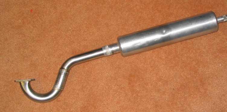

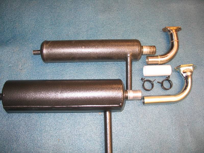

I designed a few myself but Ialways gave up sound or top end or sensitivity to prop load. The in cowl setups for gassers ALL reduce power -every last one of em. The best ones -very slight power reduction but also very low sound reduction.
the pipes which do the best job -have the most volume.
If you are into wide open running - then - yeh some small setups will tune to this type application. Helis are a good example. but I use the throtle as much as the ailerons or rudder when I fly a model. The pics are of a few examples I have used. The largish carbon fiber are the best but they require proper use and installation.
I have seen some which the users have promptly destroyed . but then some guys can wreck an anvil with a rubber mallet.

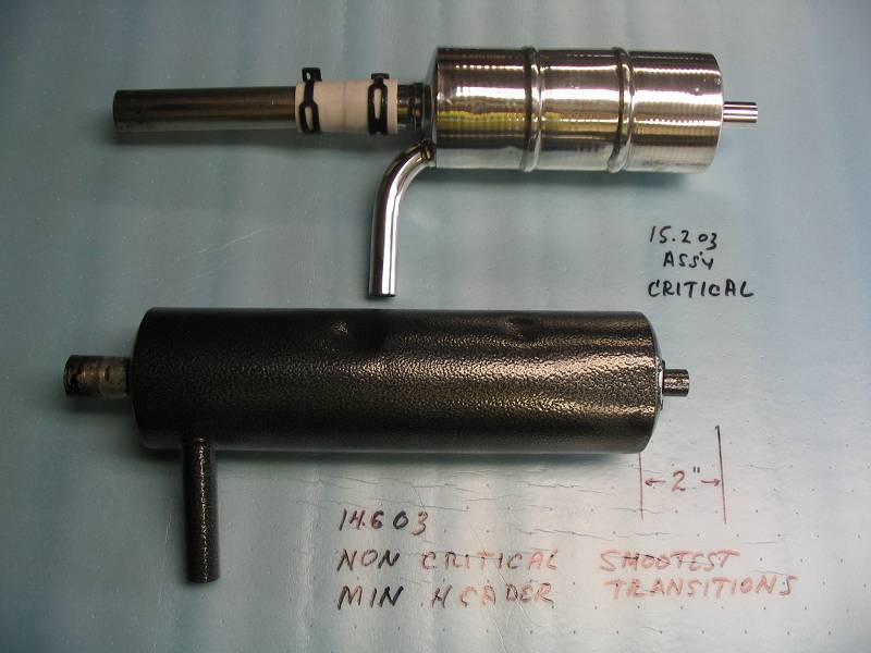

The examples you use are for heli engines. Helis are not rpm controlled, they are throttle controlled whilst rpm stay at, or very near peak performance rpm. These engines need a High Q-factor resonance muffler. (high-Q means narrow power band)
Plane props are rpm controlled, and need a much larger power band, thus they need low-Q mufflers, which add less to peak power, but make the engine very tractable. Low-Q goes hand in hand with larger volume.

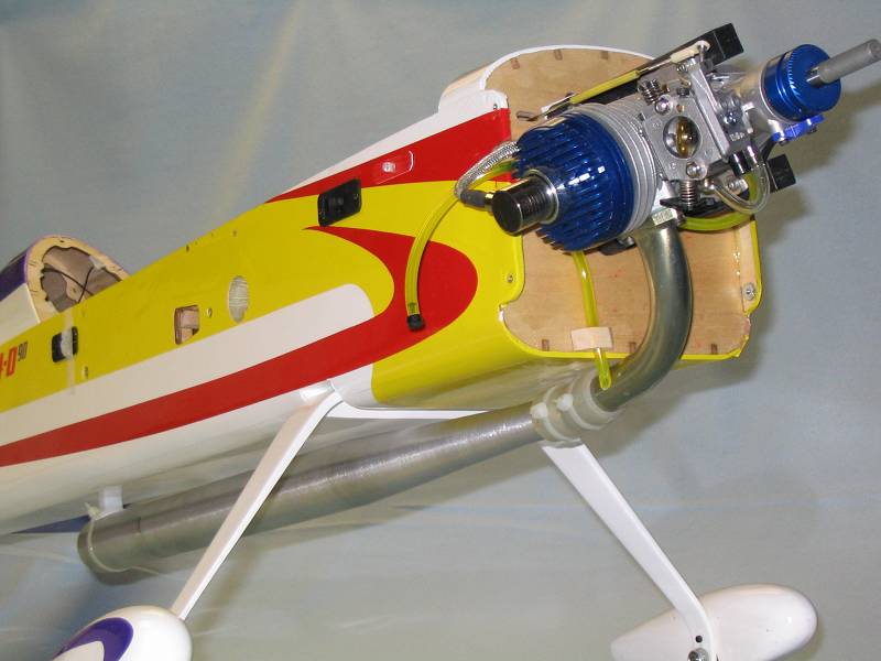

I think what you want is a good canister setup, it is much shorter than a pipe, can be very quiet and makes way better power than any in-cowl muffler setup. Done properly, a canister system will equal or even exceed open exhaust power levels.

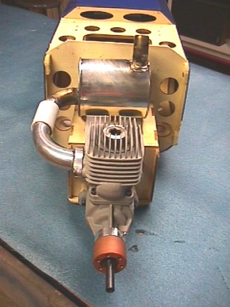

My PIP muffer (shown)was also tuned and worked extremely well but operated in 8000-11000 rpm range.I abondened the whole project when the potential supplier lost interest in the low sales volume project.
Most flyers do not care to learn to match engine prop/exhaust .
It's a buy n fly world .
