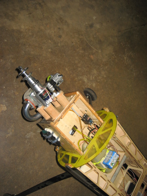

Old 11-02-2008 | 08:01 PM
My Feedback: (31)
Posts: 7,415
From: Kannapolis, NC
Default RE: Engine Standoffs
I keep a closet pole around the garage and i go to wacking when I need a spacer

Old 11-02-2008 | 08:16 PM
Posts: 2,127
From: Kerrville, TX
Closet pole, huh? I buy 1" - 1.5" pine dowel. Saturate the standoffs with CA glue after they're finished. Keeps them from soaking up gas/oil. I feel that large diameter wood standoffs soak up vibration and torsional forces better than narrow metal ones. Cheap too!
