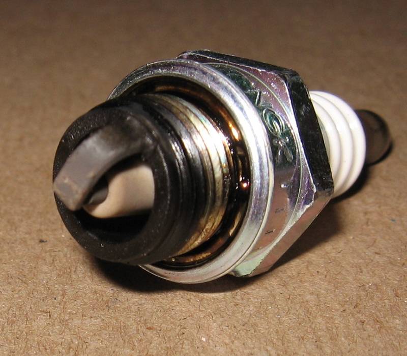

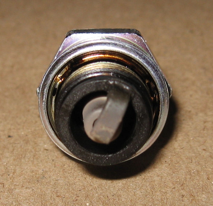

Would appreciate assessments of the "tune" of the engine this plug was in.....these are un-retouched, no color alteration, white balance "normal".
ID:	1064207   Click image for larger version

I'd read it as just slightly lean.

It's really hard to tell because you are not showing the bottom of the insulator where the reading is taken.

Without knowing how much fuel has been burned by the plug I would also say just slightly lean. Plugs in a correctly adjusted engine will, many times, look slightly lean after only a couple of tanks. If this plug were in my engine I would not be alarmed at all, I would just give it about an 1/8 turn richer and check it again after a couple more runs.

Looks real good, perhaps very slightly lean, but hot. If it came out of a twin it could be the plug farthest "downwind" from the intake rotation. Heat's not moving away as much as you might like it to.

I am very appreciative of all the opinions shared thus far! Please keep 'em coming.
Pat - single.
About 2 hours on the plug.

If that is 2 hours of running on a fully broken in engine I would be tempted to leave it alone. But Bob, I have read many, many of your posts, been to your website and I am confident you know how to adjust an engine and are a fair judge of carbon, have you had a problem or are you just testing the RCU'ers?

It looks very much like a 50-1 plug, synthetic, that's in a very well tuned engine. I've seen a lot of plugs with 25 and 50 hours on them that came out of engines "flow tuned" on a bench that looked almost exactly the same. That engine appears to be running in an rpm range that's above the middle most of the time.
I would be quite happy to see my plugs look that good.

I read the plug just about right on. I also think she has been run hard some times. I think that is what makes tiny white specs on the dark metal threaded ..end of plug. Capt,n

At a first glance I said a little lean. I think it should be a little tan or light brownish.

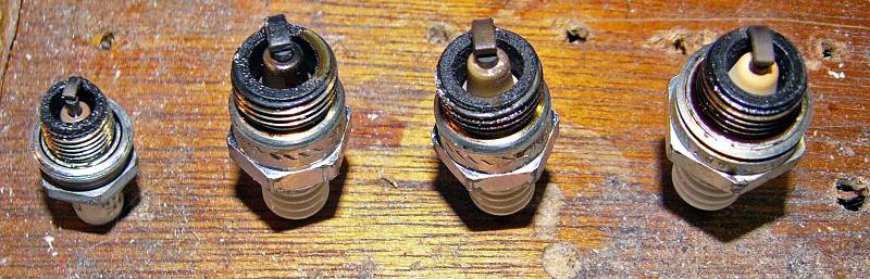

I just plugs out of four of my engines, I think the MT engines are tuned the best, left to right:
3W-75 I just got this a couple of months ago, original plug, flown mostly 3/4 throttle, 2 gallons through it since I got it. Bell Ray 50:1, 26x10 TBM 5460rpm, NX26x10 5800rpm seems in good tune.
Brillelli 366GT Pennzoil 50:1, flown mostly 3/4 throttle 3 gallons on plug. This engine is hard to tune, no-matter how I tune it it runs great. TBM 22x8 6660rpm, Vess22A 7200 rpm.
MT62 Pennzoil 50:1 flown 7/8 to full throttle, 4 gallons on plug. It exactly matches the Brillelli in rpms with the same props, great running.
MT50 Pennzoil 50:1 Flown full throttle 95% of the time, 3 gallons on plug. BME 20 3D A & B, or a 22x8, I just forget what it turns, runs great.

Bob,
Look at this picture. The black ring shows the tune
Edit.
the isolator tip shows plug heat grade (if mixture is OK)
It is where the isolator meets the plug body that shows mixture strength. Can be seen using a maglite
The plug body rim has importance as well. If oily, the mixture is too rich. Black is OK
The central electrod shows ignition timing. Soot should creep up to the tip. If not, ignition is too early (advanced)
Here is a picture of some plugs I disassembled. Just for the pictures. In real life, disassembly is not needed most of the time
Plug 1 is slightly lean, as indicated by the head temperature.
plug 2 is slightly richer, the black ring still is not as high as 1/4 isolator length
plug 3 is too rich. The black has crept up to 1/3rd isolator length.
plug 4 is too rich, but heat range is OK (champion DJ7Y)
Plug 5 is too lean (no black ring) It also is too cold (champion DJ6J black nose)
plug 6 is right mixture as shown by mixture ring, but too cold.

Your plugs may be a tad cold, and your tune too rich. The engine may still have great power, but plugs foul in time if they cannot burn themselves clean.
In my picture there is the narrow black mixture ring, where the isolator meets the plug metal housing. The tune of the pictured plug is slightly lean, but that is the best tune if cooling is OK. A wider black ring is better, but it should not exceed 1/4 of the isolator length.

The black ring Pe is referring to can best be seen with a coddington magnifier. (At least that's the best way without cutting the plug apart like Pe did here.) It has a built in light that can illuminate the very bottom of the insulator and a magnifier that allows a good view of the base of the insulator where the mixture ring will be seen.

Hmm. I just cut the plugs to cure my own ignorance and curiosity. The lessons learnt were quite iluminating. When you know what to look for, there are many ways to skin that cat.
In the end, do not forget to examine the piston top, piston bottom and skirts . They all contribute to understanding how well the engine (as a person) feels. I mean, the big picture that is made up of ignition advance, cooling, plug choice, fuel grade, carb tuning, oil type, and oil / fuel mixture.
