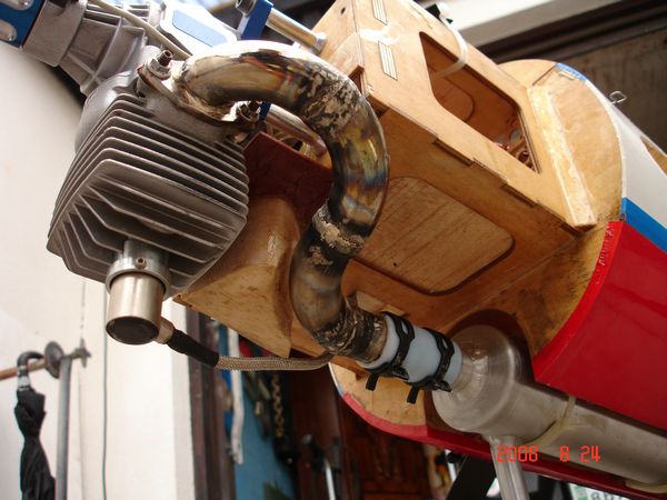

ORIGINAL: octanehuffer
You will never see a tuned pipe in a warbird. You will never see a canister muffler in a warbird either. Where is the room?
Guess what muffler is mounted behind this MVVS 45 in a Spitfire built for [link=http://www.youtube.com/watch?v=vB-RBFxyqls] a commercial [/link], which has much the same nose lines???
ore can be read about this project [link=http://www.prme.nl/forum/viewtopic.php?t=182]here.[/link]

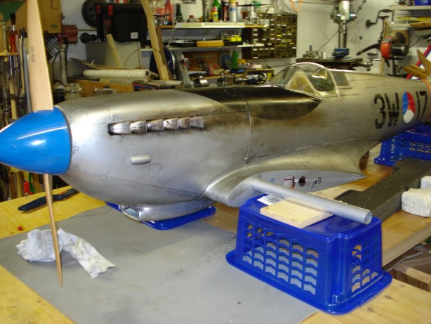

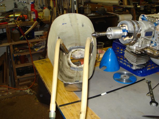

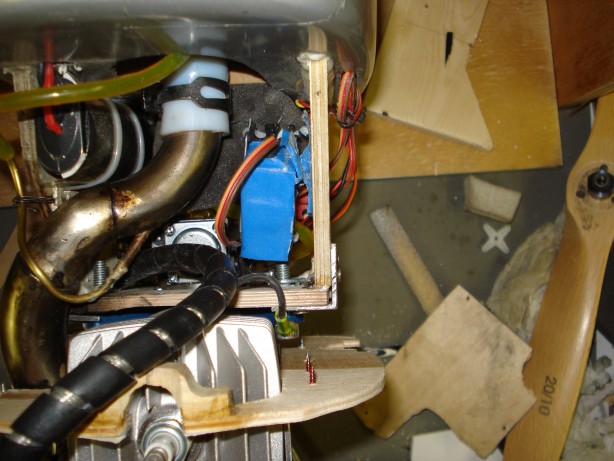

Default RE: evolution 58 or DA-50 ??
The spitfire plane was an ARF of 210cm span (scale 1:5.5). For the commercial, the engine ran without cooling!
Old 11-12-2008 | 12:35 AM
octanehuffer's Avatar
Joined: Jul 2006
Posts: 922
From: Lakeland, MN
Who made it? Are they available. Was it canister ready?
Old 11-12-2008 | 02:45 PM
Posts: 6,571
Received 5 Likes on 5 Posts
From: Arcen, , NETHERLANDS
No it was not canister ready. Just a sandwich shell, which was cramped full of equipment by the builders (not me).
I just made the engine, muffler system and prop extensions, so it would all fit inside. Only thing visible for the initiated was the spark plug cap just a tad in front of the carb air intake.
The pictures that I found will show a bit more, of how the smoke was ducted from the canister stinger to the scale exhaust, how the canister proper was inside the fuselage, etc.
