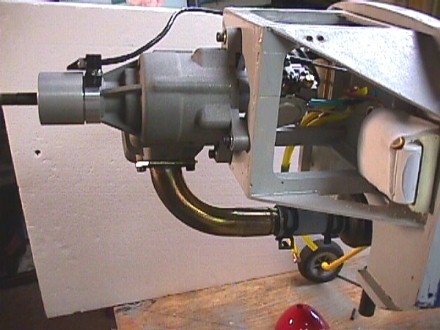

Old 05-29-2003 | 09:18 PM
rmh's Avatar
rmh
Posts: 12,630
From: , UT
Default engine and can
close up view of can and special landing gear - I used 3/16" dia music wire -bound at bottom and spread at top - the covering is high shrink heat shrink tubing.
The gear weighs 8.8 ounces.
It is much less expensive than aluminum and takes up shock loads better than aluminum or CF-
If it is badly damaged the replacement cost is under 8 bucks.

Old 05-29-2003 | 11:03 PM
rmh's Avatar
rmh
Posts: 12,630
From: , UT
look at prior thread - I screwed up and did my posting wrong--
it is a ZDZ60 w/ WJ38A carb-my addition
