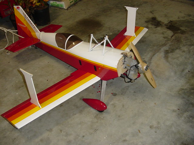

Default RE: Small gas engine question

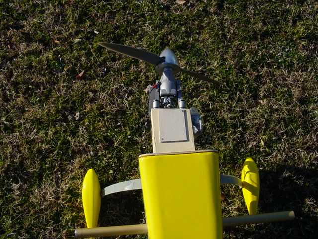

I disagree. A G-26 in a .90 size model is a lot of power.
Vibrate? Yep. Kind of like a single-cylinder.
The 43cc in my 1.60 size Ultimate is a beautiful match-up.
Edit:
Removed foul language
