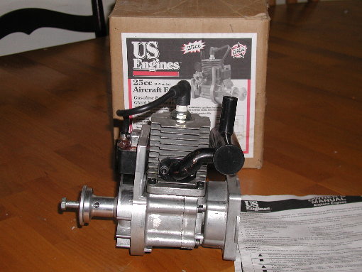

Old 06-17-2003 | 01:22 AM
Bill Rademacher's Avatar
My Feedback: (77)
Posts: 472
From: Rineyville, KY
Default U.S. Engines 41CC
here is a pic of the 25. A lot of metal on the front.

Old 06-17-2003 | 01:34 AM
My Feedback: (77)
Posts: 472
The exhaust is on the back of the cylinder on the 41 too. I have had both, still have two 41's
I love them both!
Old 06-17-2003 | 11:13 AM
Tmoth4's Avatar
Posts: 2,205
From: Northfield Center, OH
rameleni,
If it's a 25cc it'll have side exhaust. If it's a 41cc it'll have rear exhaust.
The US 25cc is based on the Homelite weedwhacker engines. The US 41s are based on the old Quadra 35-40s.
Jim

Old 06-17-2003 | 02:20 PM
Posts: 4,925
Received 5 Likes on 5 Posts
From: Kingston, ON, CANADA
The 25 also has a bolt on cylinder. the 41 cyl. is part of the upper crankcase. The plug is also slanted back on the 41.

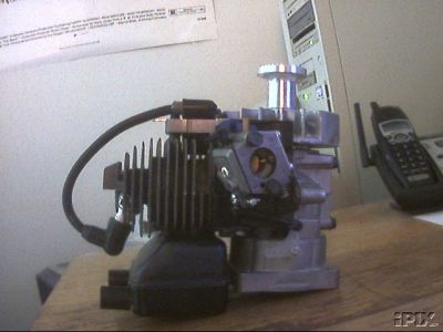

Old 06-23-2003 | 07:31 PM
My Feedback: (10)
Joined: Apr 2003
Posts: 74
From: Glen Ellyn, IL
Default 41 engine
I still am not sure which engine this is. I just put a picture of it in my gallery. I measured the exhaust port. It is 1"x 1/2" square. I called hobby services, and gave them the model number. They also said it is a 25cc. everyone who see's a picture of it, says its not a 25cc.

Old 06-23-2003 | 08:31 PM
Tmoth4's Avatar
Posts: 2,205
rameleni,
That is definitely not a 25cc. It's a 41.
Jim
My Feedback: (77)
Posts: 472
That motor is either a US 35 or US 41, but it is definitely not a US 25.

Old 06-24-2003 | 01:54 AM
Tmoth4's Avatar
Posts: 2,205
Forget those serial numbers and model numbers. It's a 41cc according to your picture, possibly a 35, and definitely not a 25cc. The 25 has side exhaust and the spark plug points straight up out of the cylinder head.
Old 06-24-2003 | 01:57 AM
Posts: 4,925
Been working on these things for about a 100 yrs take my word for it. its a 41 . Early form of it was in a Frontier chainsaw.

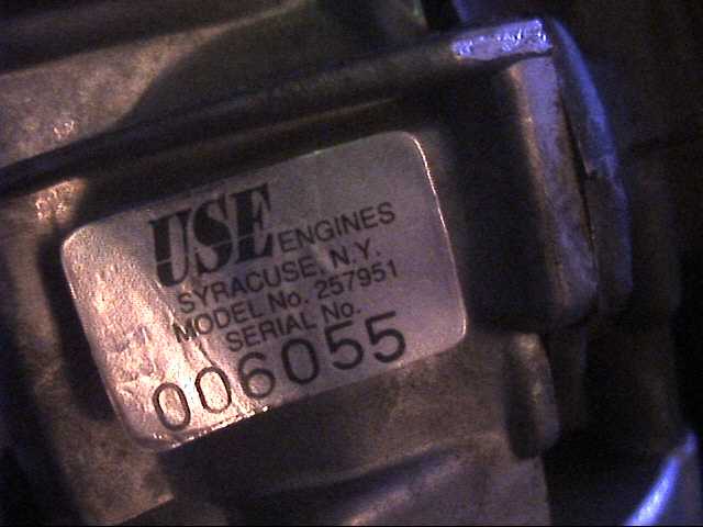

Old 06-24-2003 | 11:00 PM
My Feedback: (10)
Joined: Apr 2003
Posts: 74
Default engine
Here is a pic of the sticker on my engine.

Old 06-25-2003 | 01:09 AM
Posts: 4,925
Doesn't matter what the tag says, it's still a 41.
