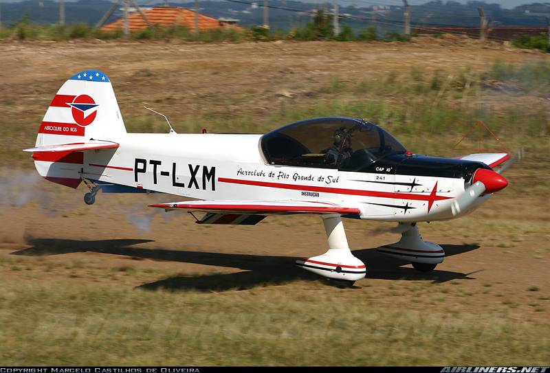

I have a 40% sport scale homebuilt kit here. It is a low wing aircraft with side-by-side 2-place seating. It is the Piel Emeraude airplane.
http://www.fly-imaa.org/imaa/hfartic.../v9-3-19a.html
126" wingspan 35-40 pounds RTF. Recommended engine size is 3.1 - 5.2 cubic inches. (50cc - 85cc) I don't build heavy, so let's assume it weighs a maximum of 40 pounds RTF.
I want more than scale performance. I want knife edge performance. Not slow high-alpha knife edge. It's not a 3D plane. I would really like medium to high throttle knife edge performance.
Consider that I fly at 6000 feet and there is about 10% - 15% drop in engine performance here.
What engine would you put in it?

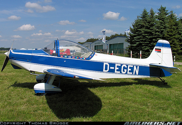

Me thinks photos 2&3 are of Cap 10's

Me thinks you are correct.
But the Piel Emeraude was a predecessor to the 10 (with most similarities stopping at the cosmetic points).
One of the best "vintage" aerobatic trainers by the way. I used to love the lines of the Cap 10 (full scale) back in the day. Cool airplane!

The Emeraude led to the development of the Cap airplanes. Amazing huh? The Mexican Air Force still uses them for training. I am planning to bash mine into a Cap 10B. That explains the desire for more power.
I was thinking a 120 would be pretty snappy, but I really have no idea. 40 pound airplanes aren't something I have ever flown. After asking a couple local friends, seams all the Caps, Yaks, Extra in the 40% size are using 150cc - 170cc engines, some of them are on pipes too. Those do have unlimited power at this altitude.
I'll start looking at 120cc - 170cc engines. Thanks guys. [8D]
