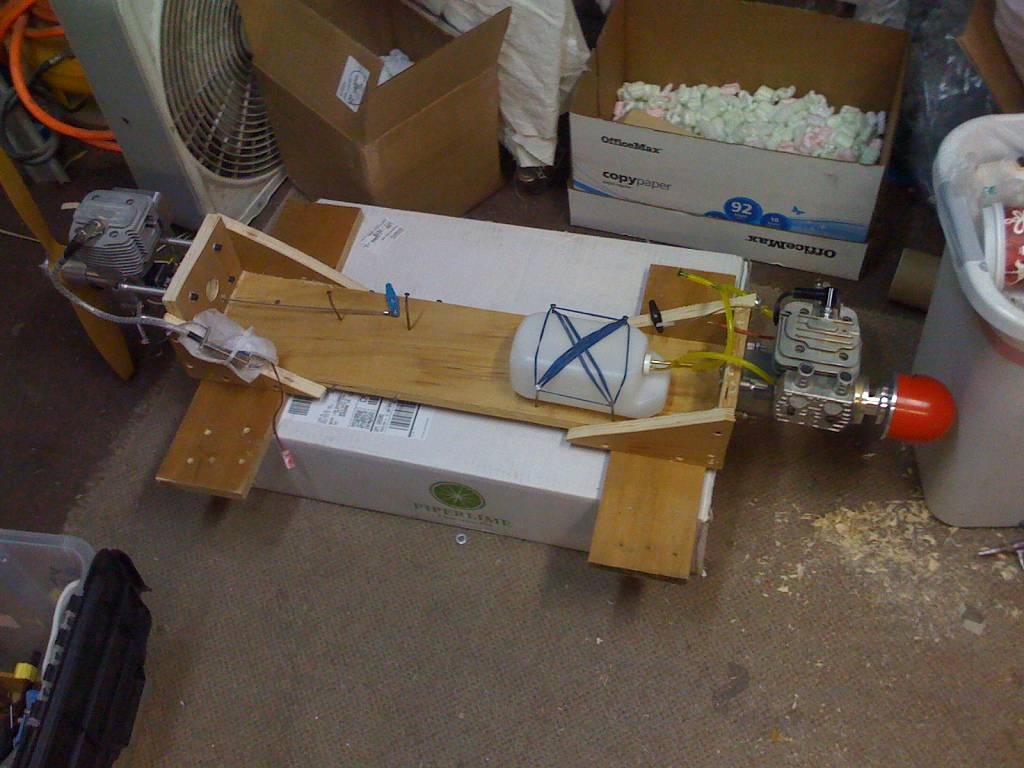

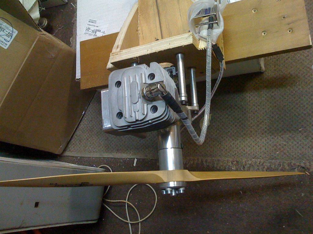

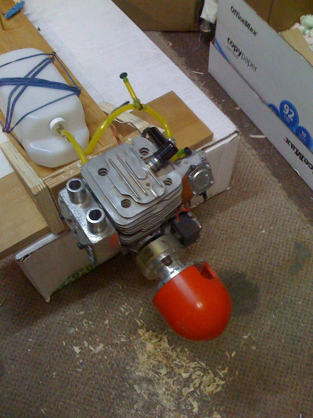

Well got both motors mounted. I don't know the condition of the G62, I got it recently from an RCU member, didn't feel like bringing my airplane to the field just to run up my other G62. The piston inside looks clean so I am guessing a few gallons but looks likes it been through the rough with broken fins. I will swap the mufflers around Jtec and B&B to see how each muffler performs.
I will find out tomorrow how well the RCGF 62 runs. Mounted on it is a Zinger 20x8-14 paddles, which I often use on my Zenoah G62
What I mean to say the screws 'wobble' means I feel there is play when the screw is in the thread, if you take apart the motor, insert the screw where it suppose to be and there is a slight play, even almost in. It only tightens up when it bottoms or two motor pieces mate up. It will work, just not the best, hopefully loctite is my friend here. I even cleaned all the screws with alcohol because it appears to have some black grease, loctite will not work to its fullest with grease. I fly 3D electric helis and I can tell you right off the bat how a heli will hold up on the long run by how well the screw fit the taps. The heli clones are notorious for bad tapping jobs and its why they are cheap. If this RCGF holds up then its not a concern, only concern is when someone does not go through the motor.
On the Zenoah G62, I converted the plug to use the same CM6 plug. I was planning on reducing the overall dimension using a carb bend on it but decided to try the RCGF motor on my next P51 mustang. I mounted a spinner to it as I can use a starter on the G62.
I don't know if the cylinder head casing is from the same factory but they look identical, however it does not have the Zenoah markings on it and the side intake port doesn't look like its been capped but been shut during the casting. Yes the RCGF head has been bead blasted. IMO, its is pretty fragile. I am afraid to roll it on the table while working on it, but not so with the Zenoah version.
Henry thanks for the info specially the walbro make.
Vic

Well, I am not liking this RCGF 62, I am actually loving it! 6-7 flips then pop, remove choke, set to high idle one flip and she runs! The needle setting is just about right, 1/8 turn in on the low needle result in very quick acceleration. Ran for 20 minute at around 2500-3000, played with idle at the end of the first run and got to 1500-1600 rpm without it cutting out with excellent transition to full power. Ran it again for another 20 min at 3000. I then tach'd and play with high needle setting to get these values at a safe cool setting. The motor is smooth at the low idle and high rpm, however vibration is strong around 2000-2200 rpm. The motor is mounted on the stand so it could be different on a model.
Here are the tach reading from both motors using a Zinger 20x8-14 paddles and 40:1 Evo Synthetic oil, 87 octane.
With the RCFG 62, B&B muffler at high rpm was 6650, with the Jtec high rpm was 6800.
With the Zenoah G62, I need to go through the carb and install a carb kit I think, when I worked on it last night I saw the previous owner used silicone seal between the carb and the intake manifold blocking the vent line... duh! I only found this because I replaced the manifold using the easy carb link kit. However it ran well enough for me to tach the high end setting, also idled well but could not adjust the low end correctly for a clean transition.
What I got with the G62, B&B muffler 6750 rpm, with Jtec rpm was around 6850. Assuming this motor has around 2 gallons through it at most from the looks of the piston.
The sound of the Jtec muffler is better as it has a deeper tone and was 150 rpm better than the B&B muffler which was slightly smaller but with longer exhaust stacks. I forgot the stock RCGF muffler so no data on it.
Well I am pretty happy with the RCGF motor... idles well and I am sure it will probably reach 7000 on that prop fairly soon. I think this motor is more than enough for my 1/5 scale mustang!
