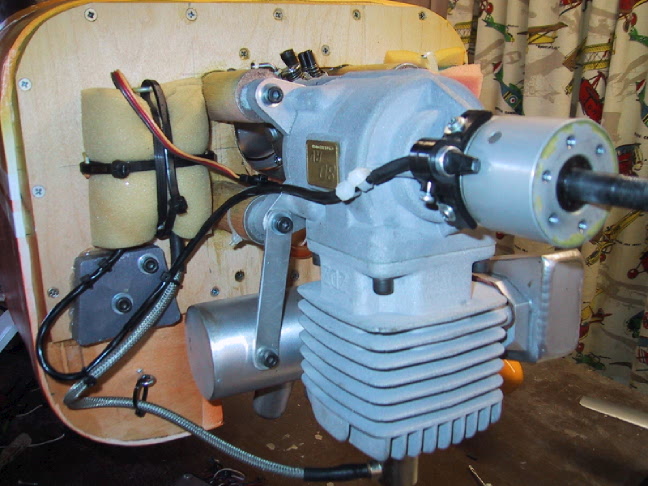

Big_Bird's Avatar
Posts: 4,258
Received 7 Likes on 7 Posts
From: Arlington, TX
Default RE: Engine Standoffs
I have been using 1" red oakdowels to support a ZDZ80 engine on a 1/3 scale Super Decathlon for 5 years. I did cap the ends with steel washers. I don't know if that was necessary. I did build in a 2 degree slant into the dowels for engine offset. They are very light and have nevercaused any trouble.

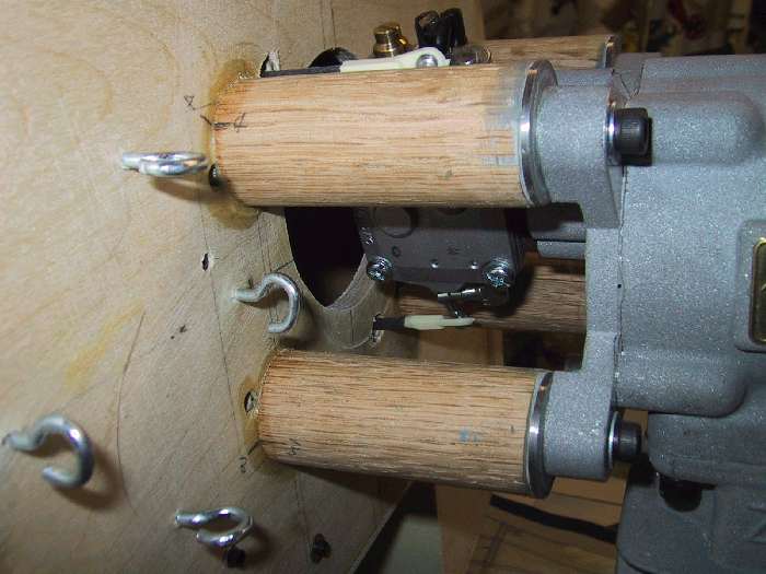

ORIGINAL: Big_Bird
Do yoour bolts go all the way through to nuts behind the firewall?
Old 05-28-2009 | 05:30 PM
Big_Bird's Avatar
Posts: 4,258
From: Arlington, TX
Yes and I epoxied the standoffs to the firewall for convenience.
