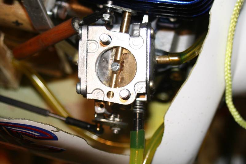

7.Close the hole or notch up in the choke plate, I'll post a picture of what I mean, I do it with soldiering the hole close, some use glue or a bolt.
After you modify the choke plate the way to start the engine is:
a. Close choke completely.
b. Open throttle half way.
c. Flip engine with ignition on until the engine coughs.
d. Take choke fully off.
e. Set throttle just above idle, flip until it starts, usually 3 to 5 flips.
Switch to Pennzoil 32:1 your engine will last forever.
Before and after pictures of choke plate modified, shouldn't take more than 15 minutes.

ORIGINAL: msayewich
will it make a difference if i tune the engine with the cowling on versus off?
It will make some difference, but you can get close, then fine tune after every flight. I put tubing on the needles to make mine adjustable while running, it helped some.

I like the tubing idea! You can make adjustments by turning the tubing further away from the prop?
Old 07-22-2009 | 04:37 PM
soarrich's Avatar
My Feedback: (98)
Posts: 4,677
From: The Villages, Florida NJ
Default RE: Bogging 3W engine?!?!?
ORIGINAL: msayewich
Yes.
