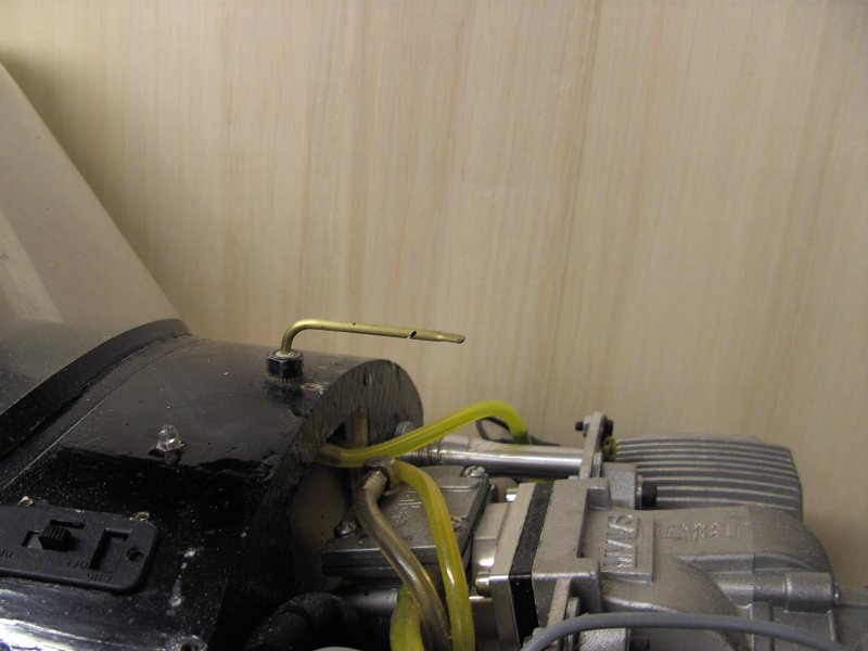

Old 07-25-2009 | 02:52 AM
Posts: 6,571
Received 5 Likes on 5 Posts
From: Arcen, , NETHERLANDS
Default RE: surging in flight
This is the static reference system that I use, based on the Prandtl tube AKA pitot tube. But just the static part of it.
