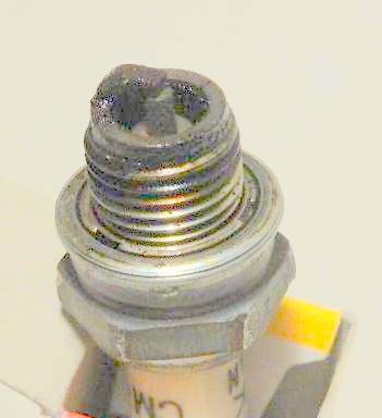

Hi Guys,
What do you think about this color? Too rich, too much oil, or else? This is a 3W 80 with 1:50 oil.
Thanks.
Onewing

Old 08-14-2009 | 08:01 PM
My Feedback: (31)
Posts: 7,415
From: Kannapolis, NC
Default RE: spark plug color
rich

You really need a better picture, I fixed it the best I could.

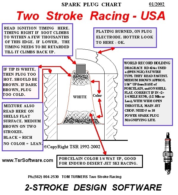

Is the little aluminum balls on the edge of the plug? The center electrode is almost all white in my picture. I got this chart from Pe's site for reading plugs.

Rich, We had an engine (116 MVVS) quit with white fluffy deposits on both plugs.
Turned out to be burnt small aluminum debris that came from the carb trumpet flange (By 3W) we had used in order to fit an air filter.
You better check where those metal parts come from. You don't want to loose your plane when the engine quits in a low hover.

That chart is quite nice, but it lacks the lower isolator mixture ring which helps defining hot or cold plugs when reading for mixture. See the picture that tells the "low-down" story. The DJ6J plugs were too cold for that engine, they read black with lean mixtures.

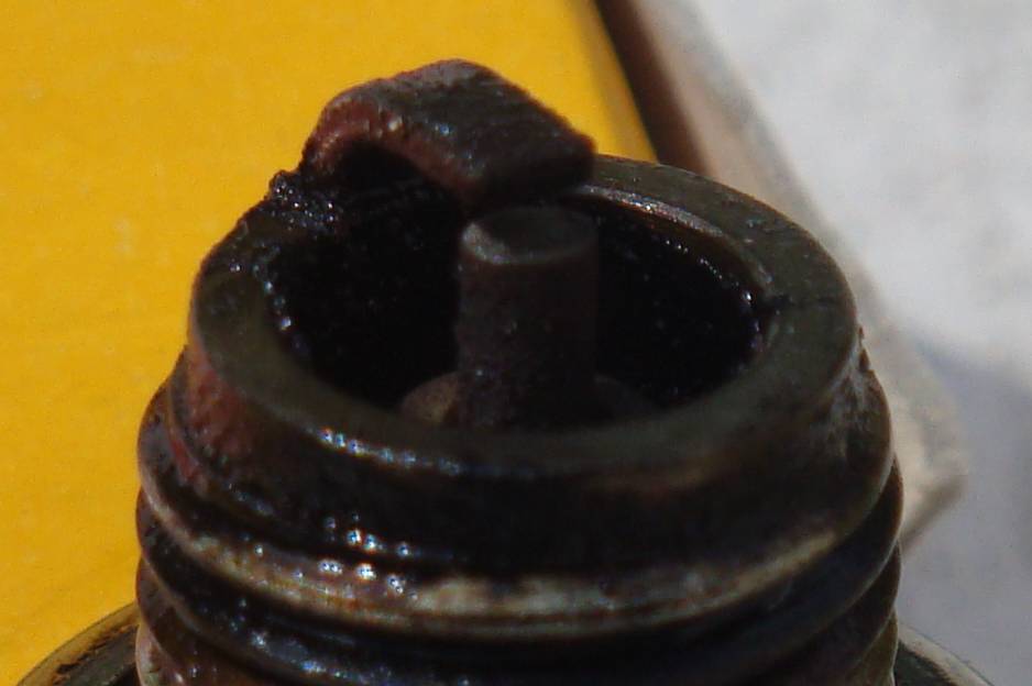

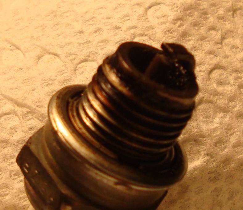

Guys. Thank you for your comments. OK, here are two more close up pictures. What do you think.
Thanks.

Old 08-16-2009 | 04:32 AM
Posts: 6,571
Received 5 Likes on 5 Posts
From: Arcen, , NETHERLANDS
The pics are quite shady and show little detail. From what I can see the plugs look sooty, as for too rich mixture.
I think you need to improve the light so it shines down into the plug. Also angle the camera to look down into the plug. 30 degrees off the plug centerline is about right.
Sunlight at high noon is best, but LED torches also are well suited.
Bulb light is no good for photographs

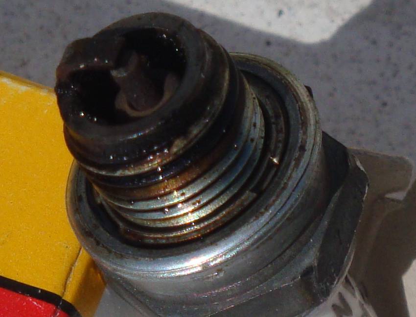

Again, thank you guys for the comments so far. That's right, I need to provide pictures with better lighting. I hope the following two pictures are more useful.
Also, this is how I have adjusted the engine so far:
1. The engine was bought new from Aircraft International two and half years ago.
2. I broke it in with Lawn Boy at 1:32.
3. Then I switched to Amsoil at 1:50.
4. I have leaned the high end needle about 1/8 turn.
5. I have never touched the low end needle.
6. This engine is on a 33 pounds Ziroli P-40. I fly very conservatively. My flights are usually short, about 5 to 10 minutes.
Thanks again. Hopefully with the better pictures and a short history about this engine, I can get more help from you guys.

Old 08-16-2009 | 10:54 AM
Posts: 6,571
The carb setting is too rich, probably on both needles.
First lean the idle needle, until the engine just about fails to cleanly accept throttle horsing. (quick forward stick). That would be the right needle setting.
Then fly, and check the plug again. The idle leaning will also have leaned out full power a bit. That is why you first have to get the L-needle right.
Full throttle flight should have the engine running cleanly, even on speed downlines. Uplines should be without sagging.
Try to chop the engine while at full bore, and glide in and let the engine cool down to check the plug.
Never put a wrench to a plug on a hot engine. That will damage the threads.

Hi Pe and Tired Old Man,
Thanks for your comments.
I put in a new plug and did some tuning this afternoon. I did my low needle first. I was able to lean it almost 1/4 turn and got a steady idle at 1560 rpm and a quick response to "throttle horsing". I also leaned the high needle 1/8 turn. I then flew the airplane for about 10 minutes. I like the low end a lot better. I did not notice much difference at the high end, as I almost never use near full throttle on this bird.
Overall, I am glad I waited for your comments, made the adjustment, before I flew again. Do you guys recommend checking the plug after a few more flights? Or check it just after this one flight?
