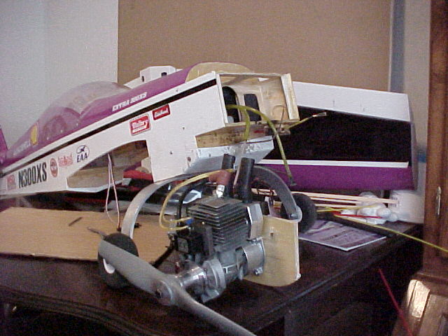

For the love of God, I hope you have done something to strengthen the firewall on that Extra. If you have any questions about what can happen see my previous posts on mine. I believe it is in the Crash forum.

This is what can happen when you are overpowered.

This is what happened to my hand because I was in front of the engine when it let go. G-38, not as powerful as DA50, 20" APC prop at 7000 rpm.

Does your SIG Extra 300 XS came with the aluminum angle reinforcements at the firewall?. Mine does and seems good.

Mine was the older version that didn't have the angle braces on it and the firewall shook loose and the glue joints failed and POW, I was hit. There was no epoxy used on my airplane at all. By golly there is now. It's reinforced with another thickness of plywood and epoxied in and pinned with six wooden dowel pins. Don't believe she will be coming loose again.
