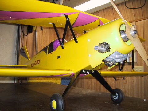

I started with the Bennett muffler on my Giant Aeromaster/RCIgn G62 combo, but cut a bigger hole in the cowl and used the production muffler after a few flights because the Bennett was just too loud. The plane does not look too bad with the cowl cut around the standard muffler. Cheap and effective. If you use a Pitts style you will have to rework the firewall area for more clearance.

I thought about using the Pitts style muffler in the beginning but decided that I was still going to have to cut a hole in the side of the cowl anyway. So, I used a J'tec muffler instead. It was extremely noisy and leaked gunk all around the the edges of the muffler. It is a two piece design and screwed together. IMO it is a poor way to build a muffler.

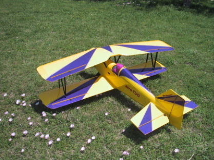

I thought that you might like to see how I built a quiet muffler out of .030" (20ga I think) steel sheet and brass tubing. It weighs 7 oz which was about the weight of the aluminum muffler.
The Giant Aeromaster with a G-62 is a great flying plane. Mine came out at 20.25 lbs.

I also have one it is one of my favorite planes. The US .41 engine is mounted on mine and it has probably enough power--still would probably rather have the G-62 as more power would be fun. The US .41 does, however, fit the cowl very well. Very little hacking of the cowl is needed and the stock muffler fits perfectly. Had to cut out a small hole to clear the the ram air carb extension and a minimal amount to clear the head. Probably needed this much anyhow for cooling purposes.

Sam, I started out with a similar problem of needing too much down trim. Also my plane was a little too twichy in pitch. I solved the problem by adding a couple of washers to each rear cabane strut and readjusting the interplane struts. This gives about 1 degree of negative pitch to the upper wing with respect to the lower wing. I also added enough weight in the tail to allow the plane to fly level with neutral elevator trim. The plane flew good before I did these mods but flies much better now.

There is another consideration on this airplane for using a US41 or G-62. It has a narrow fuselage and there is very little room to put a battery and ignition system in front of the firewall and it's a pain in the --- to put one behind the firewall. I mounted my G-62 on 1" dia hardwood standoffs so that I could put the CH Electronics Jump Start between them. Makes starting a breeze with little added bulk or weight and no battery to carry along.
