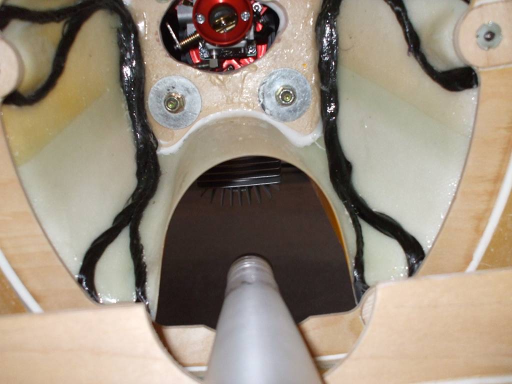

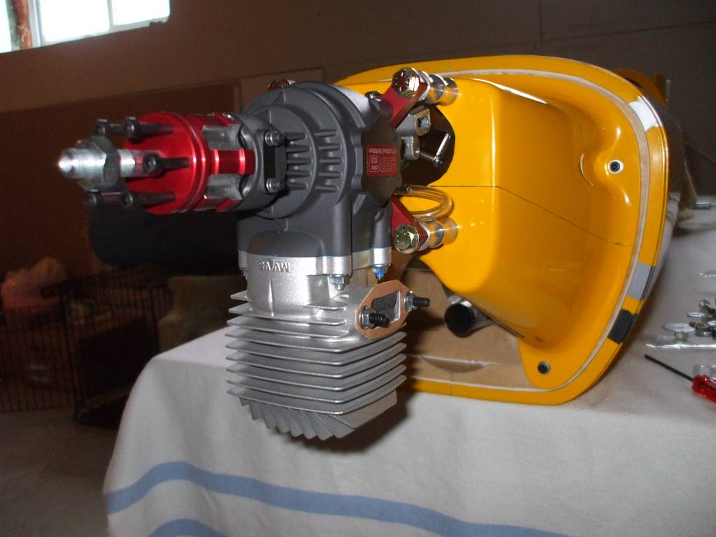

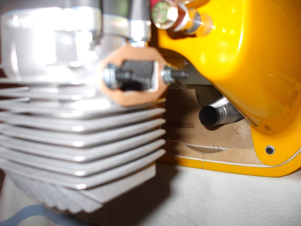

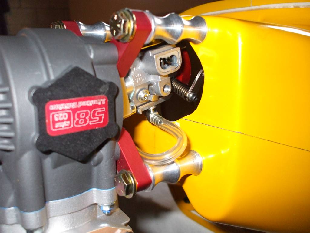

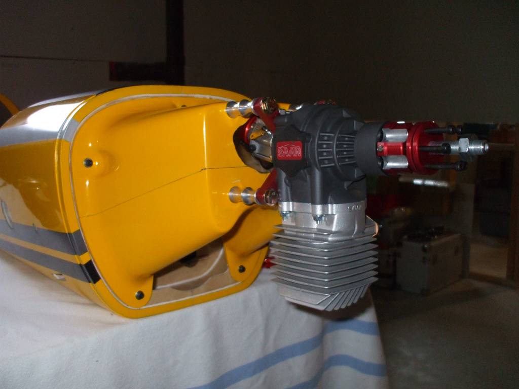

Well I got the engine mounted and the RE2 set in place now I just have to figure out the header, 16" will be great PE and for measurements what will you need?

I'll need the vertical displacement from exhaust flange to pipe entry, and the distance from flange rear bolt to start of pipe.
If your engine offset is not 2°, I need the offset as well.
When I make a header with specified offset. the spinner backplate will be dead center. My jig is built like that.

Hi Pe, well I measured it as best I could and it looks like the offset is 1/8", center of flange to center of pipe is 2 3/4" and 16" for the length. I will also need a mount set, coupler and clamps for the RE2 pipe. I put in an order on your website if you need any other information or have any suggestions feel free to e-mail me.
