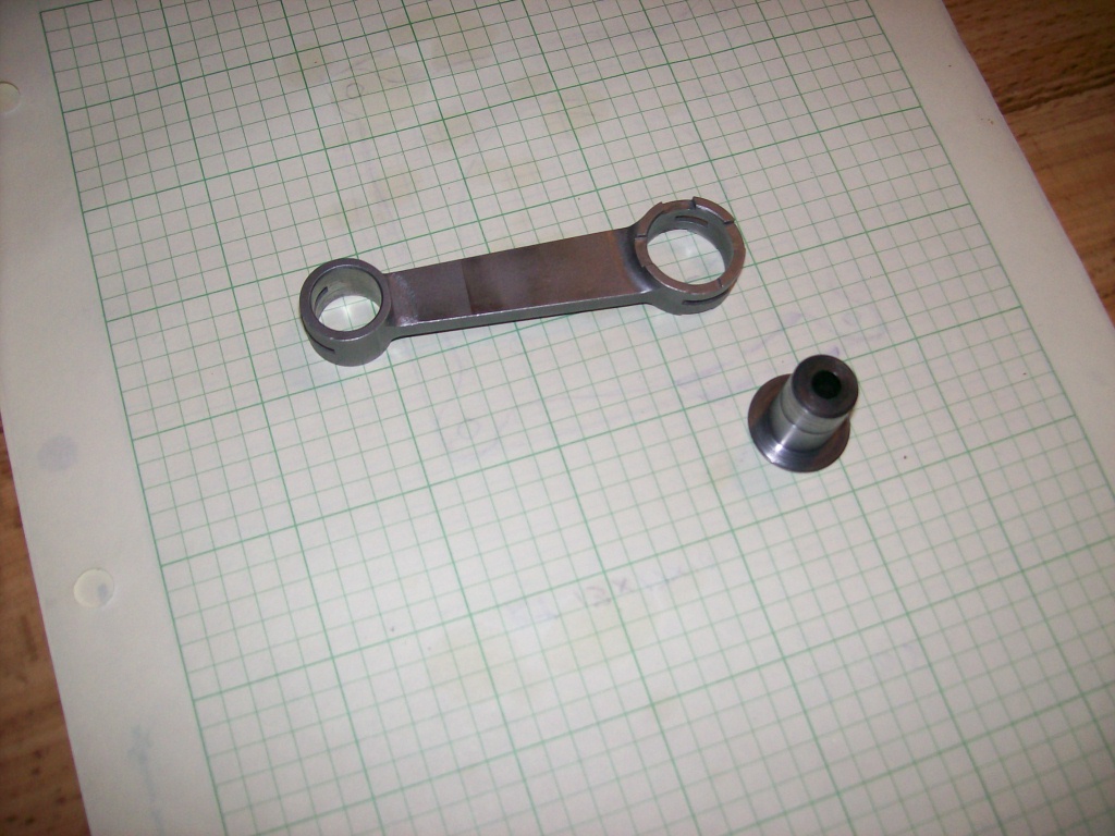

Joined: Jan 2004
Posts: 2,251
From: Blackfoot ,
ID
I finally was able to stay somewhat on track with the engine parts, Heres a couple of pics from my last endeavor.
Again I choose 4140 material for these 2 items, then heat treated both to a Rockwell of 55 C, Just the rod ends not the center part. It may not be quite as hard as needed but for this go around it will have to do. Also if anyone is wondering why I didn't cut the center down more I'm waiting on the final assy to see where i'm at for balance.
Since I am still waiting for my other parts to get in, I now have some time to plan out just what I want to do with the compression issue. I may just go the stock cylinder to start with then do some mods and see where that goes. Mapping out the ports is a little time consuming but it will let me know if there's any improvemts that can be made. I do know one thing, I will clean the ports up if nothing else. I'll have more as soon as things progress, again thanks to all for the encouragement on this.
