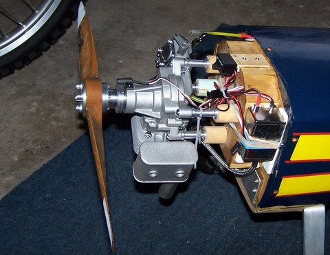

Is this a good spot for the CDI?
[link=http://www.flickr.com/photos/25908573@N05/4137363484/]hi def[/link]
Old 11-26-2009 | 07:57 PM
jedijody's Avatar
Joined: Mar 2005
Posts: 2,812
Default RE: CDI Location
Not the best place, that's probably the hottest area on the whole plane that isn't part of the cylinder. Most ignitions won't take that very long before developing problems. Would be better to move it up (or down) on the firewall as far as possible, or better yet, on the other side of the firewall.

You're not only going to cook your CDI but you're going to overheat your engine if it's going to be cowled in with no air outlet, Are those servos behind the firewall close to the ignition battery? They should be 12 inches away, at least. Dan.

Yes, the servos are only a few inches away from the fire wall. I planned to put the ignition battery right next to the servos. Do you mean the servo should be 12" away from the battery or the CDI?

If you do things right, with good connections and good equipment, the servos could sit on the battery. Not recommended, but it could be done. There's a fair number of us with some time in the hobby that locate throttle and choke servos next to ignitions and ignition batteries all the time. Even running a 72 mHz system, which is what I normally fly with.

Yes, 12 inches away from any part of the ignition system including the batteries for the ignition module. Dan.

The manual states, "for the ignition unit...don't wrap the unit by the sponge, cloth or the like...the temperature of the bottom surface of the unit will rise...make sure to leave sufficient space (a gap)."
How am I suppose to keep the vibration from killing it if I don't wrap it?

You don't need to wrap it, all you need is some foam between it and the firewall.

Will this work?

If it can't go on the other side of the firewall I would fold your piece of foam in 1/2, put all of it under your module,and use 2 zip ties.

Barely, but yes. It's the best you've done so far.
Better would be to get the ignition out of the engine box completely. The engine gets hot, and radiates a lot of hot air. This has been relayed to you before but you seem to be dead set on putting the ignition next to the engine. The life (and reliability) of your ignition will be reduced by the amount of heat it is subjected to. This is a well proven and long standing fact of life with our ignition systems. What you have will work, but don't anticipate a long lifespan for the ignition.

I'm not going to use the cowl at all. I figured there'd be plenty of airflow, without the cowl. And, I moved the CDI to the carburetor side, away from the muffler; my thought is the carb side is cooler. Did I think wrong? I could move the CDI to the inside if I have to, but it's crowded in there.
Also, I am having to add over 30 oz. of lead weights on the firewall, in order to get the C.G. within 1/2 inch of the location specified by the manual. This is really bad. I heard that Spitfires have nasty stall tendencies. All this weight is going to make it even worse. Well, I guess this plane is not going to be a lazy Sunday sport flyer after all.

No true warbird is a lazy Sunday flier. Balance by the manual and keep the nose down in the turns

I would not add 30 oz of lead...try to move engine & other ignition parts forward to get balance! Use hard wood dowel for longer stands-offs. The longer bolts you will need will add weight forward too. Capt,n P.S. A spinner & a heavy prop will help forward balance too.

Oh my. The engine weighs 35 oz. The lead weigh almost as much as the engine!
Let me do the math here for moving the engine forward. The distance from CG to lead is 7". So, 30 oz times 7" is 210 oz-in, the amount needed to balance. The distance from CG to the center of the engine is currently 10". So, 35 oz times 10" is 350 oz-in. In order to balance w/o lead, I need 560 oz-in (210+350) from the engine. That means 16" from the CG (560oz-in divided by 35 oz). So, I need to move the engine 6" forward in order to balance. That's a lot of distance to move!
I think I'm going to try to add lead before move the engine forward. I built the plane as light as I could; so maybe 30oz lead is not going to be too bad. Where can I find that much lead for cheap?

You could try moving the engine forward about 1 1/2 inches with round or square wood standoffs and the see how much lead you need to add for actual balance. Another Idea is ask the same questions in a forum that deals with airplane balance...instead of this gas forum. Best Regards Capt,n
