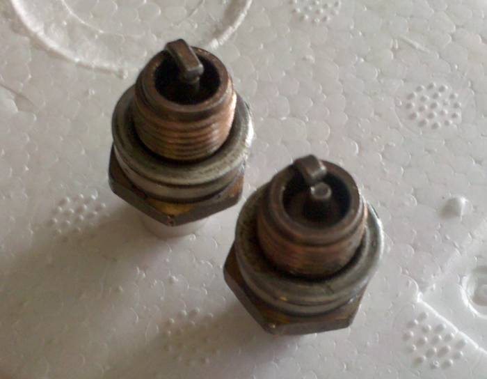

I have had a pair dl50 engines on my ziroli p38 for the last 2 years and the engines performed very well but they had the typical dl50 miss. Lately this has been bothering me a lot so i decided to try to solve the problem. I could tell the carb mixture adjustment was performing normal as the lean to rich sound was normal. So i decided to focus on the ignition.
I noticed other people on the dl50 post were complaining about the ignition timing being off on their engine so i checked mine, it was correct at 30 degrees so this was not the problem.

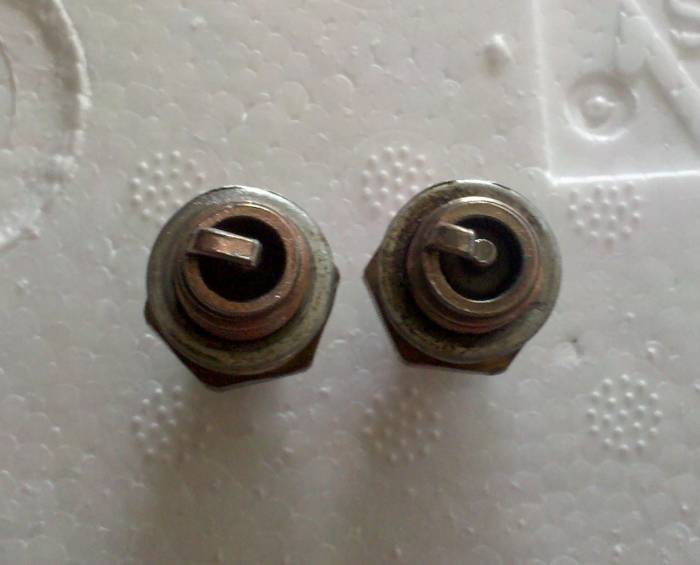

I took a look at the small stock dl50 supplied spark plug and with the spark gap less than 20 thousands of an inch i thought that maybe the grounding tab was shrouding the spark so the gas mixture was not reaching the spark on every spark firing.
So as an experiment i cut the grounding tab back to the edge of the electrode while still keeping the 20 thousands gap. I installed the plug back into the engine and started it up, the engine sounded better and after a test flight i did not hear even one miss the entire flight. My engine has never run this good.
i was amazed as how such a little modification affected my engine i wanted to share it with everybody.

Yes,
What you did, was create sharp edges to give the spark more "bite" and consistency. Spark energy likes to jump off sharp edges. It makes the spark hotter and more reliable.

ORIGINAL: pe reivers
Yes,
What you did, was create sharp edges to give the spark more ''bite'' and consistency. Spark energy likes to jump off sharp edges. It makes the spark hotter and more reliable.
What Capt'n john showed is a tuner's trick. Racing plugs have very thin electrodes for the same reasons

No telling which.
both solutions have sharp edges. The one John showed however has more material left to dress again without increasing plug gap.

John, i am going to give the ngk plugs a try. i ordered a couple 5812 plugs from Oreillys.
Normally on a car the plug gap is around .035 to .060 inch so at .020 i thought maybee the gas mixture was not reaching the spark every time. The modification i did helped the junk stock dl plug so now that i know where the problem is. I am looking forward to seeing how the ngk plugs perform.

I have the same miss on my DL 50.. I checked my timing, it was at 33 degrees, so I set it to 28 degrees. The miss is alsmot gone - more of a burble ( ground running). I then put in the filed CM6 plug - what a difference, the engine even sounded different at idle and runs fine at high end.
Thanks for the tip!
