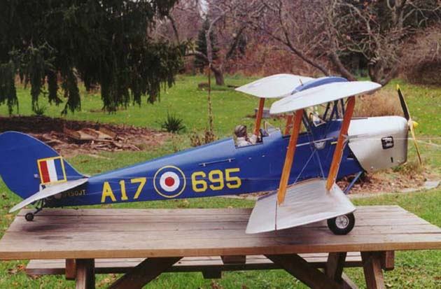

Here's a picture of the Tigermoth in question. Maybe I'm being too picky, but after all the time I spent detailing it, I really hated to have to cut a hole in the cowl. The Ryobi would be such a nice fit.

From what I can see you done a real nice job on it. As soon as i can (saturday) I'll put mine together and send you a side view and a front view so you can see how little the carb shows. OK
