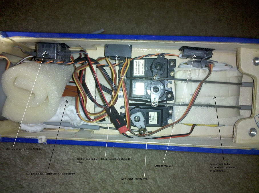

While I'm waiting for the new CDI module to get here, I am posting my latest setup. As you can see, it's pretty clean.

I want to first start out by stressing that I strongly advise against setting up a plane this way. This was an experiment, my first converted glow to gasser, and the work is very shoddy but it does work and works very well. It has been flying almost 2 years now and has accumulated about 100 hrs in it's current configuration. The engine is a Supertigre G51 converted using CH ignitions metal case SyncroSpark system. It uses a Rimfire 1/4X32 sparkplug. The point I am trying make is that if everything is right and the ignition has NO leakage it can lay right on top of the Spektrum receiver with no adverse effects. It even has the dreaded metal rod going forward to the throttle barrel on the carb.
I have had not one single glitch in those 2 years and the Spektrum data logger rarely shows any loss of any kind when checked. Once again, I strongly urge against setting a plane up in this manner but offer it as proof that it can be done with success. It also serves as a good example of how not to set up a gasser if you are concerned about radio interference. Yes, Spektrum (and all the other 2.4's) can be shot down with the right interference but they are way more robust than the older technology. I could never have gotten away with this setup on an older radio.
This thread is about CDI interference and if you have the right CDI (read the good stuff not the cheap knockoff junk) set up correctly you should NOT even have to think about interference. My hat is off to Bill and Terry and Company at CH; they make some of the most awesome ignition equipment I have had the privilege of working with. On top of that they are some of the most helpful and nice folks I have dealt with.

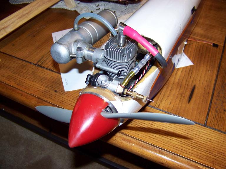

Looks like my ordeal is finally coming to an end. I received the Rcexl ignition module a few days ago. It was installed this morning, and then I fired her up in my driveway. Range check seems good. I got out to 40 paces before starting to see servo glitch, with antenna down. Lets see how she does for real tomorrow.

The first test flight was completed with only minor damage to a prop and the spark plug cap. The engine is mounted inverted, and during taxiing, the tail jumped up and caused a nose-over, thereby destroying the prop and slightly damaging the spark plug cap. I failed to keep elevator up; it was my fault. The stainless steal cover on the spark plug cap split open. So, I just force it closed again with a plier and screwdriver. Fixed. Good as new. I haven't yet been able to get the engine to run at its full potential, but it has been running quite reliably. Hopefully, it'll get stronger as it gets broken-in. Is there a simple way to protect the engine, in case of nose-over? See how the cap is sticking out the bottom.

I want to close out this thread by providing an update on the RCexl ignition and the stock "blue" ignition module, so that people don't get the wrong idea about these cheap Chinese modules and engines. The RCexl never ran right on my XYZ-26 with a 5-cell Nicd; it didn't give max power. I don't know why. The RCexl started to fail after a dozen or so flights; it become harder and harder to start the engine and tune it. The RCexl finally decided to quit sparking at all last week.
I replaced the RCexl with my stock "blue" module. The stock "blue" module has been running excellent; it produces very healthy looking sparks. The "blue" module kills my 72 FM receiver; however, my 72 PCM receiver appears to be unaffected by the noisy "blue" module.
In summary, here's my current (more importantly, good running) setup.
