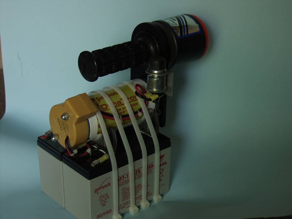

I have one of these. I have arthritis in my hands and no longer prop by hand
Original: Mac Hodges
The Miller Dynatron unit does not have to be a two hand affair. I have one that I put together that I have been using for over 10 years and it is a one hand operation that is easy to use and will start anything from a 20cc to over 150cc engine. [img][/img]
First, I join two 12 volt 7 amp. gell cell batteries with a couple of strips of thin double sided tape. Then using double sided tape, I mount two 2 1/2" muffler clamps on top of the batteries. I slit fuel tubing and put over the edges of the clamps to protect the starter. I then strap the starter to the batteries with a couple of large plastic tie wraps. But before mounting the starter, I remove the strip switch and add wire to connect to the added switch and bracket. This places the push button switch conveniently under your thumb for easy one hand use. And then wire in series for 24 volts. I sell the switch and bracket for $20. The Miller reduction unit is $125. I sell the complete starter for $275.

I would like to post a follow up on my rendition of the Hodges style starter using a Miller reducer on a Sullivan Dynatron and two 12 volt gel cells.
I took my Dynatron with the Miller reducer and made it up exactly like the one Mac Hodges has. Two batteries, 24V and all.
I used the same exact switch that he used in his picture, but I put the switch on the other side for left hand use as you push the switch with your thumb. It weighs 17.8 pounds
Here is the Mac Hodges version
The switch is this Dorman one
http://shop.advanceautoparts.com/web...633-P_N3618D_P|GRP60036_____
I managed to only get a couple starts out of the device before the side of the switch blew up. The reactance of the motor armature was apparently too much for the switch?
I then replaced the switch with this heavier Dorman switch
http://shop.advanceautoparts.com/web...905-P_N3063A_A|GRP2020A_____
I also added an audio crossover 10 uF non polarized axle lead capacitor from Radio Shack across the switch contacts and so far - so good - we'll see.
http://www.radioshack.com/product/in...ductId=2102481
Now my starter looks like this with the new and different switch.
In the near future, we are going to find out how it holds up?

Old 07-22-2011 | 09:32 AM
a1pcfixer's Avatar
My Feedback: (7)
Joined: Aug 2004
Posts: 2,505
From: La Porte, IN
Default RE: Engine Starter
I'd agree on the Dynatron Super High Torque version starter, with 2 - 12v batteries,
but instead of the heavy gell cells, use 2 3S1P LiPo's.
Much lighter!
Old 07-22-2011 | 09:40 AM
w8ye's Avatar
My Feedback: (16)
Posts: 37,576
Received 11 Likes on 10 Posts
From: Shelby, OH
If you can pick up nearly 18 pounds with one hand, there is going to be no torque response with those batteries hanging down there. Makes this set up a true one handed operation.
You need someone to hold the big plane though.

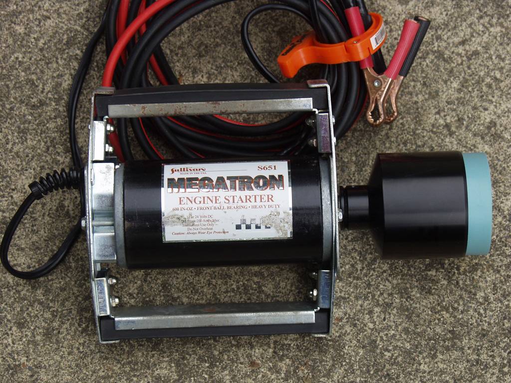

Old 07-22-2011 | 11:02 AM
w8ye's Avatar
My Feedback: (16)
Posts: 37,576
From: Shelby, OH
I have a back up starter in case the Miller/Sullivan switch fails again.
Just a minute, let me turn my truck around so I can hook it to the truck battery.

18 pounds???? Waaay too heavy!
Switch to twin 3-cell LiPo's and shave off around 11 lbs.
Plenty of torque too!
Old 07-22-2011 | 12:28 PM
w8ye's Avatar
My Feedback: (16)
Posts: 37,576
From: Shelby, OH
At only 7 pounds, you would have to hold it with both hands to keep it from twisting

Old 07-22-2011 | 01:14 PM
w8ye's Avatar
My Feedback: (16)
Posts: 37,576
From: Shelby, OH
I've been using those starters on 50 and 60 cc engines. I have a Zenoa G62 and a friend used the Megatron on his DA 50's.
Those 12V gel cell batteries are only $5 ea at the ham radio swap meets and at the surplus store up town.
Here's a video of Mac Hodges using a Dynatron/Miller with two gel cells on his B-29 which uses four ZDZ80 twins
http://www.youtube.com/watch?v=S0DxPo5tWGg
