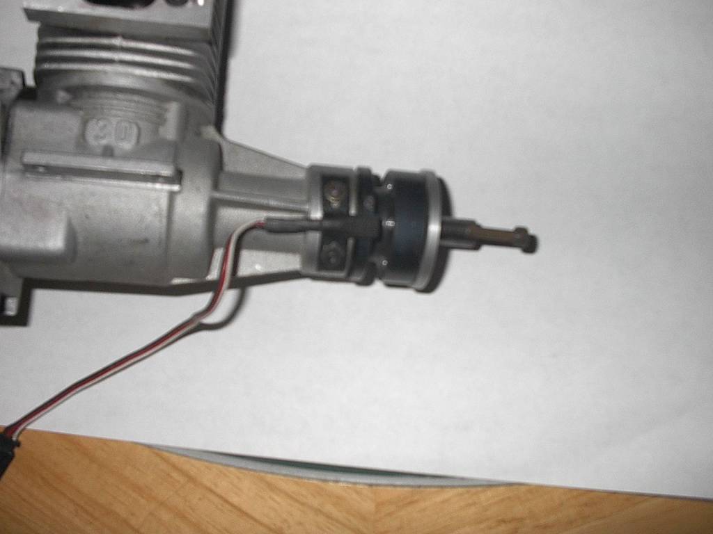

I have an older RCS 140 which has an internal hall sensor . The original ignition is no longer working . I have a spare RCEXL ignition I would like to use . The wire colors of the wire coming out from the internal hall sensor are green,brown,white . Does anyone know how the RCEXL red,black,white wires should be attached to the other colors ? Thanks in advance .

It will not work, The timing is different.
You can mount a new RCexl sensor on the front of the engine and then use the RCexl, I have one that I did that way.
You also have to install a magnet in the prop hub.
