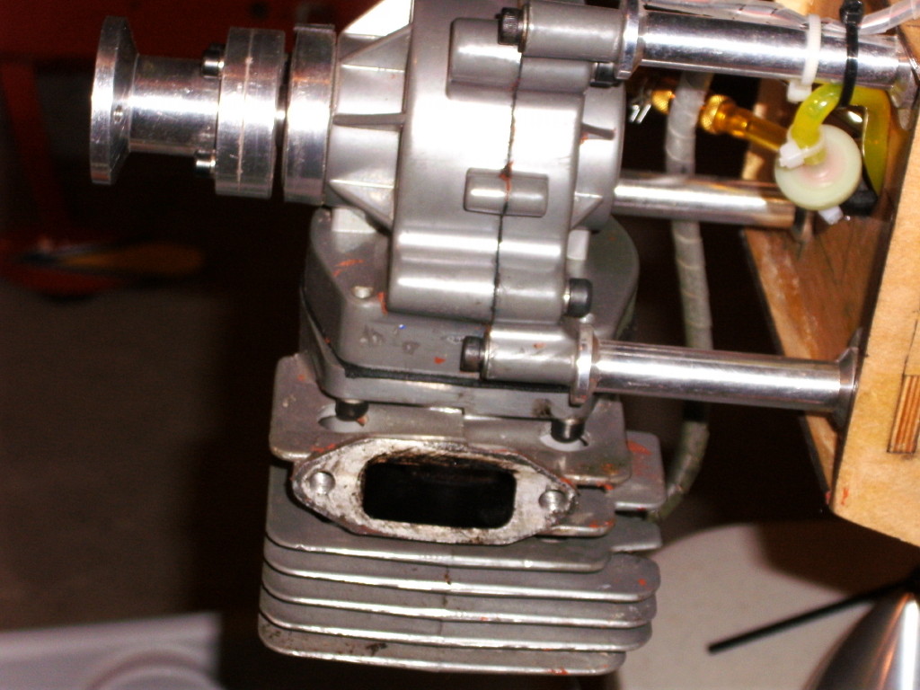

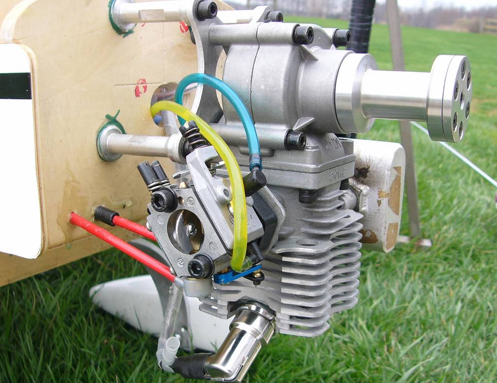

A friend bought a plane with this engine. I don't reconize it. He was told it was a 4.2. Anyone know?
Kelly

I think it's an SPE 43.

If it will swing that prop, it is no 42
Old 02-28-2010 | 01:16 PM
Posts: 18,602
From: Valley Springs, CA
Default RE: Identify this engine.
A 4.2 (68.8cc) could, but a 42cc would be sweating pretty hard in the attempt.

Thunderbolt,
The engine you have there is a RCGF 65cc. It's a bit of an antique but makes very good power and is extremely reliable.
One thing to check out for is hub run-out, the early models had problems here.
It will run props in the 22X10 to 28x10 range and do so until the fuel runs out. Enjoy it, I have 2 of them and I am always amassed how well they run.
