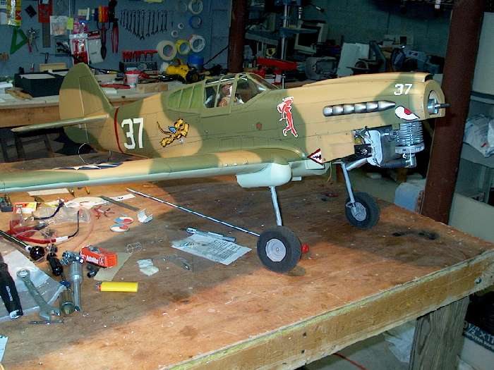

Thanks for your input. I was thinking it might be a little lean on the low needle, it is also slow to transition to full throttle. I had the engine adjusted before I mounted it in the plane, because I don't have access to the needles. I really didn't expect such a change in the mixture after mounting it. It looks like I'm going to have to drill a hole in the top of the fuselage to reach them. Really didn't want to do that.
My rcs is going in my toplite p40. It's a tight fit, but with the custom muffler from Bisson it worked out allright. I'm hoping to get the bugs out before the weekend so I can test fly it. I really hope I don't have any cooling problems.
It's a little heavy at 11 1/4 lbs. , but most warbirds are! Topflite suggests 8.5 to 10.5 lbs. I've flown the model already with a 1.20 four cycle and it did ok, you just have to really watch it on landings with the crappy robart retracts. The arms bend very easily.
Here's a picture:

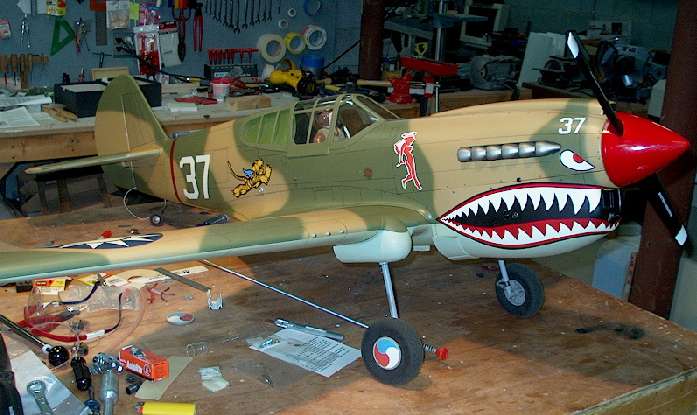

another picture
