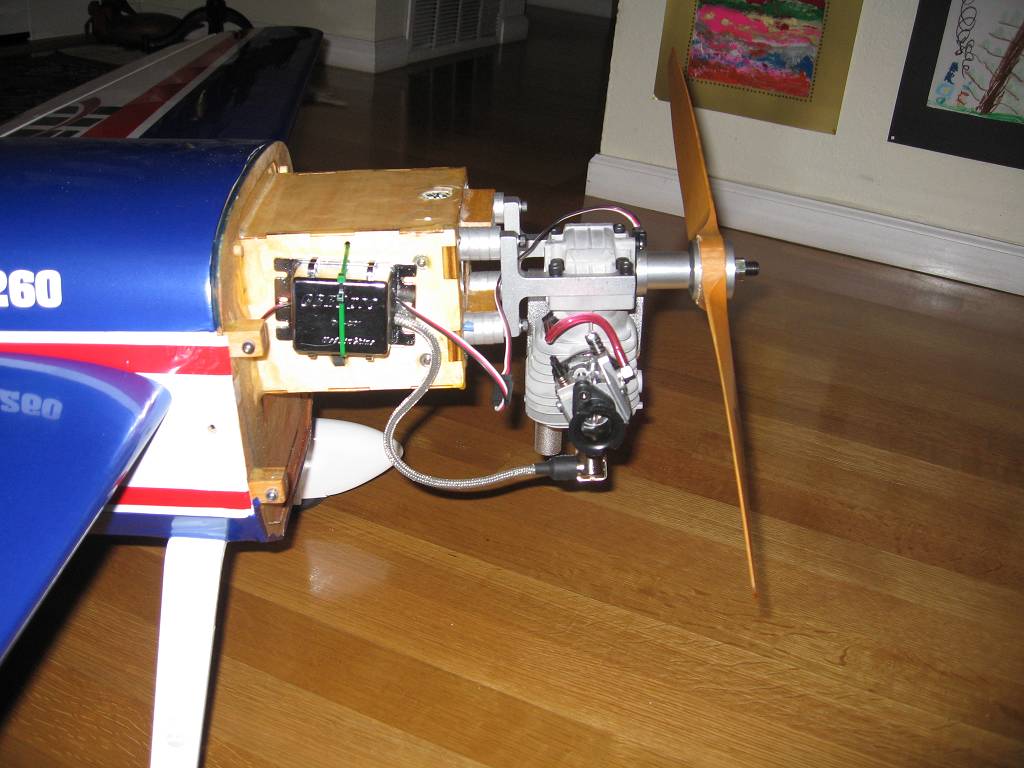

I too have a fairly new CRRC 50i Pro. It's a powerful motor that starts easlily and runs great. I have one small issue with it, though. Lately I had the first dead stick coming in for a landing. The motor cut off as soon as I throttled back to idle. When I picked up my plane I found the prop stuck. My first reaction was I have a seized motor. I disassembled the motor right at the field and, to my amazment, found absolutely nothing wrong with the internals. Everything was nice and shiny. As a matter of fact I was very pleased with the workmanship of all the machined parts. Then I found the problem. The crank has a little too much lateral play and can be pushed rearwards about 1/32". Now, this motor does not have a candilever type crank. It is supported by three bearings. That's why she runs exceptionally smooth. When the motor is hot from running, obviously the crank is being pushed back by the braking effect of the slow rotating prop, when the throttle is cut back to idle. Consequently the prop hub hits the crank case and rubs aginst it, which makes it feel like the engine suffered a piston seizure. A slight wack forward on both sides of the backside of the prop frees up everything and the motor turns smoothly again. I tried to pull the hub off the crank, but is is glued on with red Loctide and I sure don't want to heat it up to soften the Loctide. It would, most likely, destroy the magnet that's inbedded in the hub. So I tried to stick a piece of 120 grid Wet -n Dry between the hub and the case and run the motor with a starter motor, with the plug removed. The first flight after this fix was positive. No rubbing. But I still want to prevent the crank from moving axially. Other than this little problem I like this engine a lot.

Another thing I know about these engines is that they do not like to stay at idle for too long when using a wood prop, because the wood does not have enough mass to act as as a flywheel for this engine for too long.

I don't think the engine gets too hot during flight. After a flight I can touch it with my fingers and don't get burned. I also can move the crank back and forth when the motor is cold. I firm tab on the spinner and it slips to the rear. I whack on the back side of the prop and she pops forward. I think the crank slides baock and forth inside the bearings. I need to investigate.

Yesterday I had my engine apart, again. Sure enough, there is excessive axial play in the crank. Almost one millimeter. There is no movement of the bearings when I push the crank back and forth. They still seat tightly. I believe there is too much play between the rear counter weight and the rear bearing allowing the crank to shift. I suspect, when the motor gets warmed up it loosens up, allowing the crank to move backward when the throttle is cut back to idle in flight. The prop is acting like a brake when the airplane slows down. I wonder if I could place a thin washer where the back end of the crank slides into the rear bearing, acting as a shim? What is your opinion, pe reiver?
If you can make a shim that reduces play to about 0.05mm, that would be fine. Do not take out all play, because there will be no way of knowing just how much pretension you put on the bearing, and the crankcase will expand more than the shaft, for which the front bearing must compensate.
Thanks for your input, pe reivers
I know I can make a washer just thick enough to eliminate most of the play. I was thinking of even more than 0.05mm. Probably more like 0.1 - 0.2mm.
