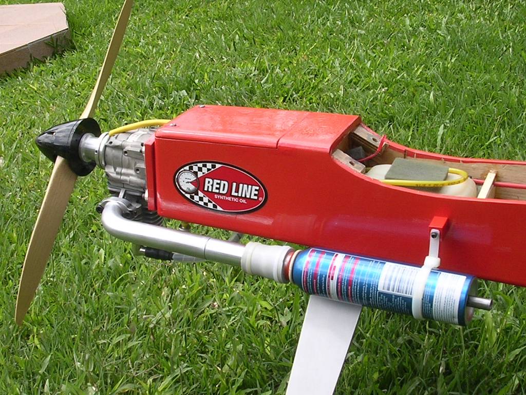

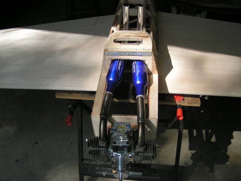

I used JB Weld. Cut a short piece of tubing the same dia as header. Then JB weld it into aluminum beer container. A high temp silicone connector joins the pipes. Capt,n My exhaust &amp; 3 others in photos<hr />

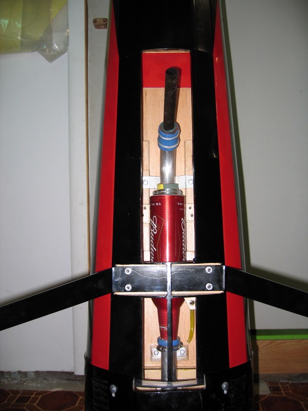

I used that method to make a mousse can muffler for my G20, see attachment.
