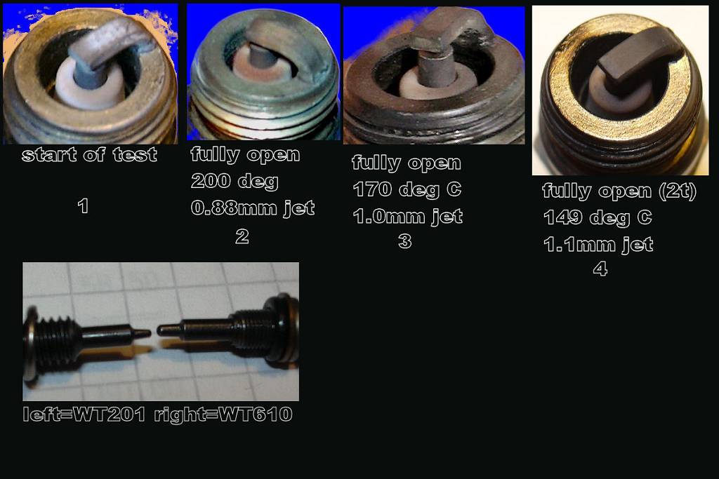

If you want to sacrifice top end power and fit a smaller carb than the original 16mm one, The WT610 would be a better choice. It has a larger mainjet than the WT201. If flying at altitude, The 201 is OK, but at sea level fuel flow is marginal.

True Ari, Too many on this forum repeat what they read or hear. Those who know this engine have quite different opinions.
Here are the results of comparing the wt201 with WT610 carb. The 201 main jet is 0.88mm, and clearly too small for good adjustments. DA50 users reported the samelimitations with this WT201 carb.
The CHT (Cylinder head temperatures)readings are with same prop, just main jet adjustments were made. Final picture, the engine still was nicely two-stroking on a large prop, but CHT was down to safe levels on my test stand. In flight needs leaner settings due to engine unloading.

So where does the 16mm carb fit in here? I'm guessing difficult to adjust or??
With your smoke header and an MTWRE2 pipe, same results as above with the 610 prevailing over the 201
