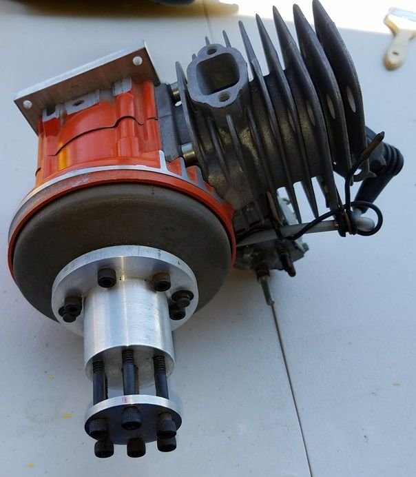

What engine is this? Sachs???
1 Attachment(s)
Can anyone identify this engine.
There is no name or identification on it as to maker or size.
The rear of the cylinder base says "Mahle"
It's about 7" tall and about 6" in length.
It has a Tillotson carb.
Any help appreciated

RE: What engine is this? Sachs???
One of the very best RC engines ever...
3.7 or 4.2 Sachs Dolmar chainsaw conversion...
Look on the base of the cylinder...a 4.2 will have a 49ZN case into it, a 3.7 will have 47 ZN..
It will outrun and outlast any Chinese engine ever made...Maybe not in WOT rpm, but any other category.,.
1000 hours cutting down trees is normal for these....In the woods...Using whatever oil the lumbejacks had on hand...

I was thinking Sachs because of the orange color.
There is nothing on the cylinder base except the letter "V" and "1 K" under that.
It pulled my 30lb plane around very well. I just have no idea what size it is.

Wow !! A blast from the past as I believe that's one of mine. I converted Sach 4.2's primarily for B & B who sold most of them for me. They were a great engine with plenty of power and durability and I built over a 100 of them. The majority of engines built since then with machined cases used the Sachs cranks, rods, pistons and cylinders until recently as we're now seeing different and cheaper internals showing up.

It's for sure that it's a Sachs engine .You will need access to the face edge of the cylinder base flange to get the cylinder # . 44ZN is a 3.2 , 47ZN is a 3.7 and 49ZN is a 4.2 The numbers should be located just behind the flywheel shroud. You may need to unbolt the cylinder to raise it up enough to get to the numbers . I'm fairly certain its a 3.2 .

The numbers are clearly cast on one face of the cylinder base flange. Not hidden at all. I’m not sure where they would put those numbers that would be easier accessed. Heck, most engines have no ID numbers anywhere.

The numbers can in fact be hidden from direct view on the OE version of the chainsaw crankcase .The OE case obstructs the front view of the cylinder flange face , unlike the r/c versions with which the numbers are clearly visible from the front of the engine

Dolmer saw used the Sachs and Mahle cylinders
Dolmer 115i for the 3.2 and a Dolmer 120 super for the 4.2 .
Dolmer 133 for the 5.2 and Dolmer 143 for the 5.8

I have a Sachs that looks just like the one Keefer posted. I verified it's a 3.7 and found a guy to rebuild the carb. I got a new spark plug but am not getting any spark. I think there may be rust on the magneto, but I can't figure out how to pull that shroud off the flywheel to get inside and take a look? Any ideas?

If like the one above, that engine appears to be an EI conversion as there is no visible mag coil. Maybe one of the ones that Ralph Cunningham did or something similar? The EI would appear to be behind that cover where the flywheel once lived. The cover should come off if you remove the prop driver hub. But just guessing as I haven't worked on that version Sachs before. Look earlier in this old thread and you can see the mag equipped version as the flywheel and coil are clearly visible.
