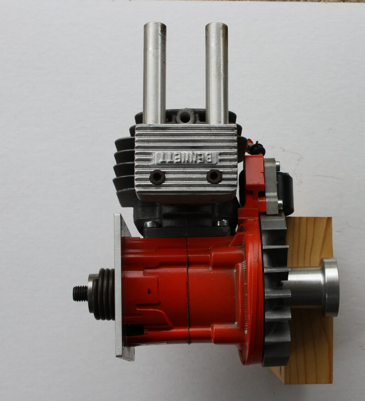

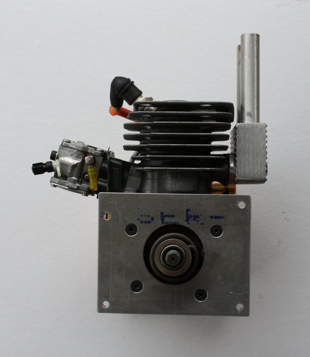

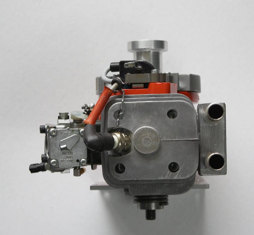

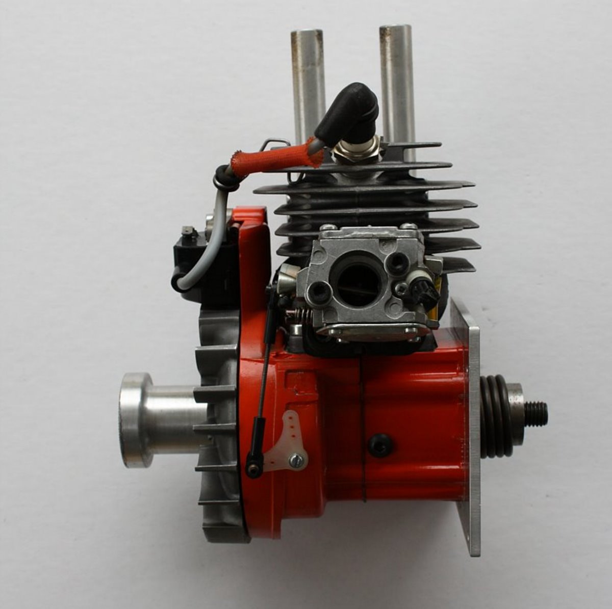

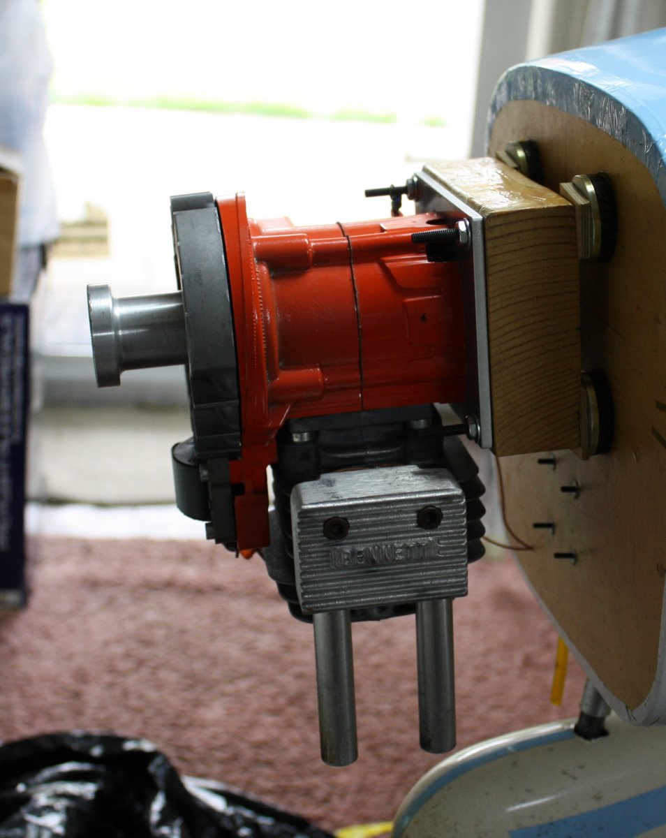

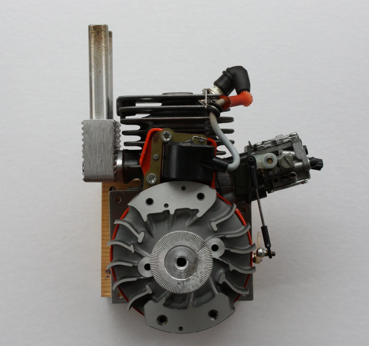

Can anyone identify this engine.
There is no name or identification on it as to maker or size.
The rear of the cylinder base says "Mahle"
It's about 7" tall and about 6" in length.
It has a Tillotson carb.
Any help appreciated

One of the very best RC engines ever...
3.7 or 4.2 Sachs Dolmar chainsaw conversion...
Look on the base of the cylinder...a 4.2 will have a 49ZN case into it, a 3.7 will have 47 ZN..
It will outrun and outlast any Chinese engine ever made...Maybe not in WOT rpm, but any other category.,.
1000 hours cutting down trees is normal for these....In the woods...Using whatever oil the lumbejacks had on hand...

I was thinking Sachs because of the orange color.
There is nothing on the cylinder base except the letter "V" and "1 K" under that.
It pulled my 30lb plane around very well. I just have no idea what size it is.

Wow !! A blast from the past as I believe that's one of mine. I converted Sach 4.2's primarily for B & B who sold most of them for me. They were a great engine with plenty of power and durability and I built over a 100 of them. The majority of engines built since then with machined cases used the Sachs cranks, rods, pistons and cylinders until recently as we're now seeing different and cheaper internals showing up.

It's for sure that it's a Sachs engine .You will need access to the face edge of the cylinder base flange to get the cylinder # . 44ZN is a 3.2 , 47ZN is a 3.7 and 49ZN is a 4.2 The numbers should be located just behind the flywheel shroud. You may need to unbolt the cylinder to raise it up enough to get to the numbers . I'm fairly certain its a 3.2 .

Originally Posted by bjb050
Hi,
I have a Sachs that looks just like the one Keefer posted. I verified it's a 3.7 and found a guy to rebuild the carb. I got a new spark plug but am not getting any spark. I think there may be rust on the magneto, but I can't figure out how to pull that shroud off the flywheel to get inside and take a look? Any ideas?
Bernie
If like the one above, that engine appears to be an EI conversion as there is no visible mag coil. Maybe one of the ones that Ralph Cunningham did or something similar? The EI would appear to be behind that cover where the flywheel once lived. The cover should come off if you remove the prop driver hub. But just guessing as I haven't worked on that version Sachs before. Look earlier in this old thread and you can see the mag equipped version as the flywheel and coil are clearly visible.
