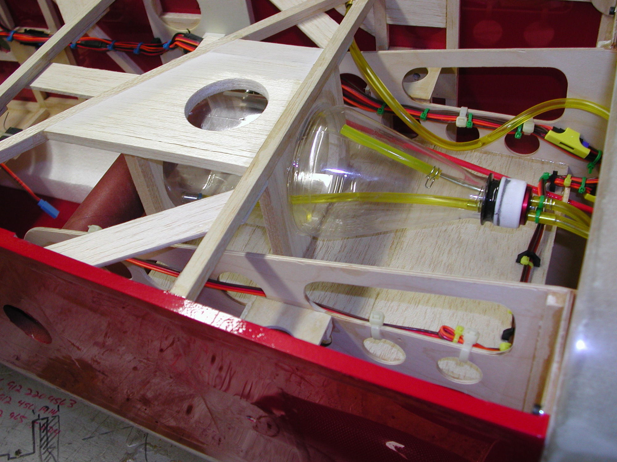

Although I don't do any real violent 3D I do want my engine to run as well as I can make it. For me the solution was to use dual 1 liter tanks with felt clunks. Keeping the engine cool is important too and you should baffle around the cylinders as best you can.

Properly installed with a flexible fuel line, the felt clunk works extremely well at keeping the engine supplied with fuel even during violent maneuvers, keeping bubbles out of the fuel supply and keeping it clean, and using up all the fuel in the tank.

I hear the felt clunk works great, but have never tried one myself, I run clear tanks that I can see inside of while using the old normal brass clunks, I do double filter all gas going into my airplanes and have done so for over 3 decades without a single fuel related engine out issue while flying 3D or not.
