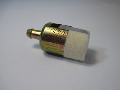

I have always used the felt clunk, after cleaning/replacing many carb screens over many years I have never found felt in the screen.
The felt does not shed into the line, anyone who tells you that has never used one.
Just buy one of these and your problem will be gone

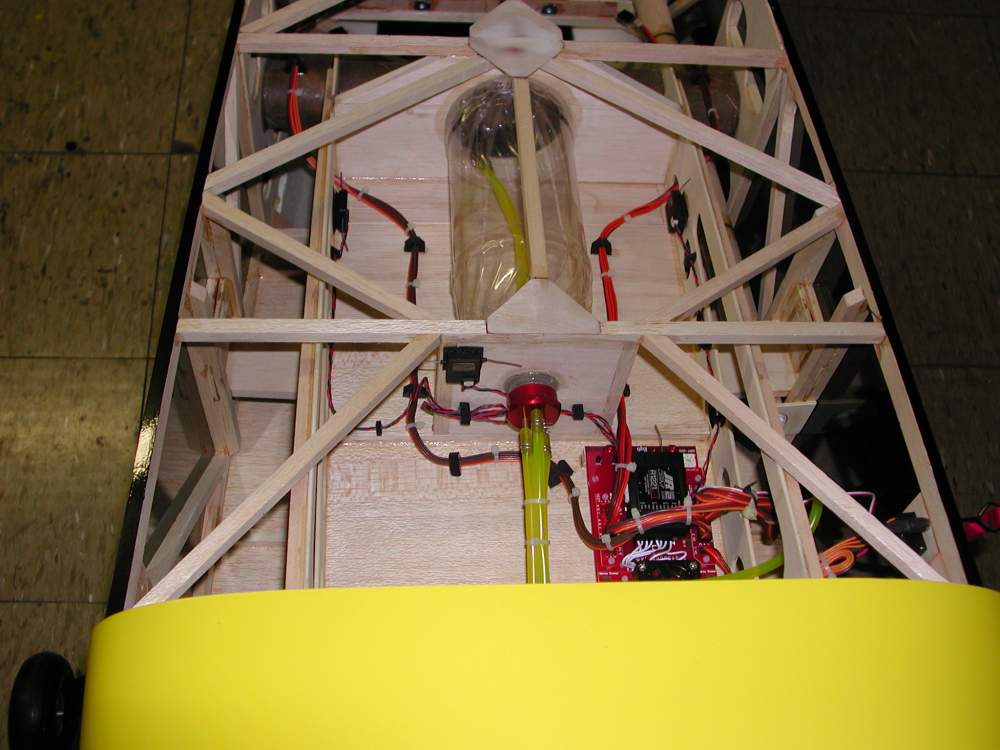

Received 17 Likes on 15 Posts
From: SAN ANTONIO, TX
I hear the felt clunk works great, but have never tried one myself, I run clear tanks that I can see inside of while using the old normal brass clunks, I do double filter all gas going into my airplanes and have done so for over 3 decades without a single fuel related engine out issue while flying 3D or not.
