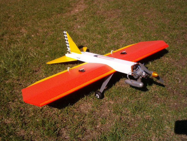

A fuselage like this might do it, but any idea on how to be able to use foam non planked wings???
How are RC Combat wings build and reinforced for being able to be not planked??? guess its only pink foam, a spar and Tape.
oddy,
There already is an event designed to escalate into AMA 424. Read the Club 40 forum.
The planes are no longer cheap, but they are relatively inexpensive. Club 40 sport engines can be had at swap meets for $30.00. At Dayton, I bought one for $20.00 and one for $25.00. Also, there are probably a lot of them in your club. After that, escalate to Club 40, which uses BB engines, the most popular is the same engine used in AMA 424.
Besides that, the planes are great flying sport planes.
Check it out.
Ken Erickson
