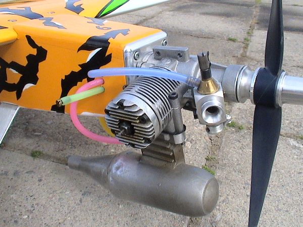

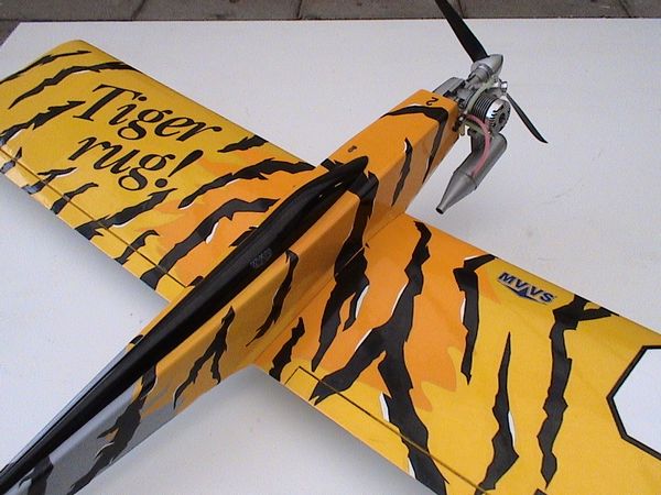

Hi!
1. The prop of choice is depended on many variables. Such as airframe drag, weight and what type of performance you want (speed or climbing performance).
Let's take an example:
In Sweden we race Q-500 pylon with side exhaust .40 engines using 80/20 fuel with 10x6 plastic props.
The engine of choice for the last two decades has been the Webra .40 GT.
That engine turns a RAM or Graupner Cam prop (svept tips) at around 14000 rpm on the ground.
Max speed is around 160-180km/h.
We are not allowed to use Tettra "Bubbleles tanks.
That plane would go faster if we changed the prop to a 9x6 or allowed 15% nitro! But it would probably climb bettetr with a 10x6 prop.
If you are using no nitro fuel and want better performance without doing radical things like raising exhaust timing you can: 1. Raise compression by removing a head gasket and at the same time use a colder plug.
Those to things goes together...low compression means hotter plug a high comprssion means colder plug.
Then you ask : What is high compression? And what is low colmpression? And what is cold and warm plug?
This is something you learn by racing!!
Take the first example again!
In my Webra GT .40, With which I have won many races, I use a Nova Rossi 4 glow or Rossi 3 plug and standard 0,2mm head shim. Using an OS 8 or Enya 3 (which are good sport plugs ) will not perform as good.The difference is not that much noticable , only 100-300rpm. But easily recognized both by listening to how the engine sounds and how the plane performs in the air. It is possible that there is better plugs available but in my 30 years of racing I have not found any better ones.
If I would run that engine on 15% nitro fuel I would probably had to use a much colder plug like a Rossi 5 or 6 plug to obtain better performance and at the same time probably lower compression adding a 0,1mm head shim.
