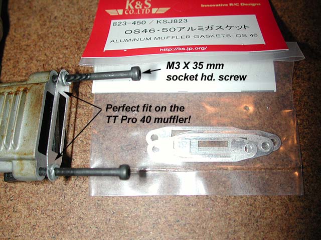

Well...these are certainly readily available, cheap, and easy enough to make so they could be replaced at every muffler removal. Still, I'd love to have METAL GASKETS ala Nelson and Jett.
Question for you guys that don't use gaskets: Do you lap each mating surface on a dead flat board with 400/600 grit paper attached?

A group of guys I fly with, have been using the KS Aluminum Muffler gaskets available from Horizon.
http://www.horizonhobby.com/Search/D...Id=EPMA&Page=4
I had been using the Hi Temp silicone for many years with great results, but it is nice to be able to swap engines at the field, and not have to clean and wait for the silicone to dry.
Randy

Bingo! Thanks Mike Tallman and Randy...
http://www.horizonhobby.com/Products...?ProdID=KSJ823
Budman - your stuff must fit better than mine does.

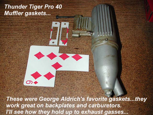

This will bring closure to my question as to the source of aluminum or brass gaskets for the TT Pro 40 muffler. They fit PERFECTLY! Once again, here is a source:
FWIW - those gaskets made from a playing card work fine, but only for one use...they become so brittle from the heat they self destruct when you remove the muffler.
Thanks again to Mike Tallman and Randy!
