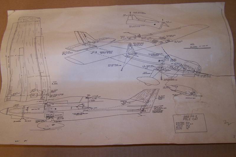

I recently got this kit from a club member. He got it from a friend who was clearing out his hobby room. I can't find any info about this plane. Is anyone familiar with this kit ? I need some building instructions or at least a little guidance. This is all it came with, and there are no tail plans.

Measure the length of the wing (actual wing) , then measure the length of the wing (on the plans), then measure the length of the tail on the plans.
Take the Actual Length of the wing and multiply by the measured tail length (on the plans) and divide by the Length of the wing on the plans. This will give you the length of what the tail should be.
Is there an elevator Joiner included with the kit?
What specifically do you have questions about? There are enough people here that can talk you through each step, looks like most of the hard work is done. It is a nice looking plane.

Thanks DAVEN. There are no tail plans to measure. Yes, it does have an elevator joiner, which hooks up inside the fuse. I did find the rudder (which is fiberglass also). The firewall is already glued in and the wing is already sheeted (foam core). It appears the formers are all here. I plan on putting a West .50 with a tuned pipe on this plane, but not sure which way to mount it. The pipe may give me problems. I am not new to kit building, however this is my first fiberglass fuselage.

In your second picture above (the middle one) there is a top view of the plane. Measure the tail on there.

Hmm, this is interesting. I think that it may have been designed by Bob Root, since the isometric drawing is nearly identical to the Stinger that Root designed before handing it off to Don Rice. The basic glass work and shape matches up with the Stinger as well, like one was made from the other's plug to make the mold. "SRS" might refer to Bob Smith, his brother and Root, but that's a guess without researching the history. Email Bob at his glue factory and he could surely tell you for certain.
You have an interesting piece of history, and more than likely the molds are long lost. You should have someone splash the glass before building.
The tail would have had around 75 squares with a 15-16" span, of 1/4 balsa sheet.

I realize this is an old post but I just joined, The kit for the polecat was sold by
bob violet in the mid to late seventies. I am curently building one that I have had since around 1977, I also have another unbuilt kit.

This is a very old post, so all the origional suspects may have moved on to other crimes. The airplane shown is clearly NOT a Bob Violet Polecat. There are several clues, but two will be sufficient. On Violet's Polecat the virtical fin was not molded in as part of the fuselage. Also the cockpit area was done differently. There was no molded in floor on the Violet airplane, and the canopy was mounted from the underside. I suspect the airplane shown here is a Dave Layman Polecat. If the origional "poster" still needs information on the size of the stabilizer, myself and others could provide it for the Violet Polecat. Good luck, Greg
