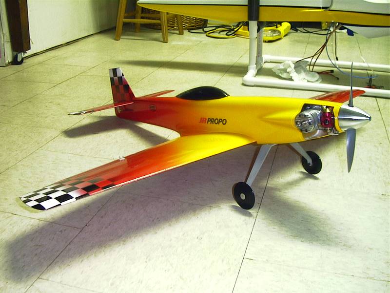

G'day mate,
If you care to do a little modification , a wild hare LR-1 might be the go , waddaya think ?
I have an LR-1 with a BSE35 in it and this thing is in the 150 to 160 mph bracket , turns up 19600 static and unloads in the air like nobodies business
You would have to modify the hump on the side of the plane just behind the cylinder to clear the exhaust header , also the firewall has to be moved back apox. 1/2 inch.
If you are interested let me know and I can help you out with this project , being from the home country myself I know the mentality of the aussie hobby shop , you start talking speeeeed and they get scared , I send stuff back to my flying mates in Mudgee , NSW (home) all the time.
Check out the pic.
