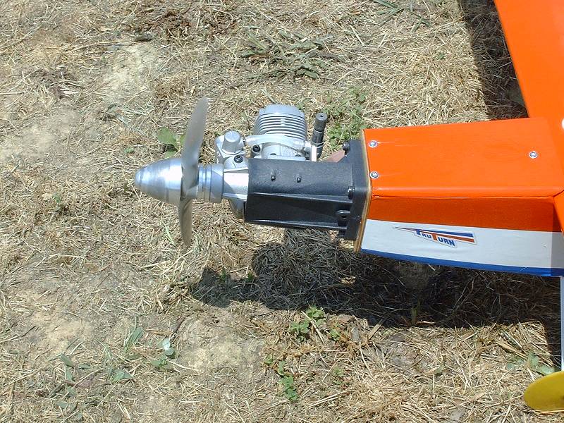

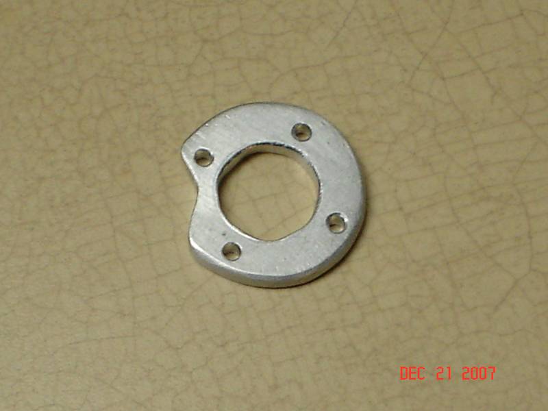

Probably has already been done, but I wanted a different way to mount the .25FX on the back plate. Because of the remote needle, you grind or space it. Some use spacers or washers, the first one I used a nylon mount. Then I found plate aluminum, and a hole saw...

Since the viper / Predator always comes out tail heavy with the OS and similar .25 engines, I have always used the Dave Brown 202L glass mount and bolt it to the backplate mount. Saves adding weight.

Yes Chuck, that's why I'm setting it up this way, I raced Oct/Nov with them this year. What a blast! The new one is going to be .25 only, the battery will be up front, and a few other things changed, and I'm hoping it will balance. My other Viper has the Dave Brown mount screwed to the back plate, and I can change out to the ST .45 by sliding the battery back a little. Now if I could just figure out what is a good RPM number for these FX's, and the best prop/fuel, I'll be good to go!

K&B used to make ring mounts for their old greenhead engine series back in the fifties.
I have .09, .15, and .19 rings around here someplace. They look just like the one in the first picture.

The [link=http://www3.towerhobbies.com/cgi-bin/wti0001p?&I=LXK805&P=7]Hayes AL-25 Long Mount 1.19 .21-.25[/link] is the perfect mount for the .25 engines on Quickies. The 4 bolt pattern is exactly the same as the backplate mount. Plus you can move the engine forward for balancing purposes. And at $4 is it very cost effective. I drill and tap the engine mounting holes. Some use the self=tapping screws, but I like tapped holes.

Did you need to add weight to get yours to balance? I know several others did, thats why I stuck my engine out there to get the balance without a weight penalty.

I use a 700 mAh NiMH battery in my Quickies. With the .25 FX mounted as shown, I put the battery in front of the tank in the tank compartment. I move it to the radio area when I have a TT Pro 40 on the front. It does require shifting the battery, so it is not a heat of the contest day conversion. But I don't have to add any weight. I use a JETT CG tank against the former at the front of the wing.

On my Q25 I used a long Hayes mount, similar to what Don did, but added a Higley Heavy Hub and bolted some lead onto the mount, tucked in behind the engine. My tank is up in the front of the airplane, butted up to the firewall, and the battery on the CG, Rx at the back of the radio compartment. I have it set up so I can swap engines quickly, TT .40 vs OS .25 FX or vice versa, without the CG changing. just four bolts and the throttle linkage. I don't even need to take the wing off to do it. My Predator II ends up 2 oz lighter overall with the 25, vs. with the .40.

So far, with the battery in the tank area, it looks like the balance will be ok. I'm not quite finished. I thought having the shorter nose was a better thing, that's why I mounted it like this. Plus the firmer an engine is mounted, the better for rpm. This is just stuff I've heard, no data to back it up. As Electric Delta pointed out, our speeds seem close, we clocked my other one at around 90, Joe's was faster, I think 95-96?
