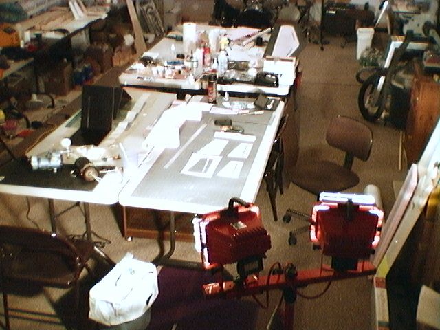

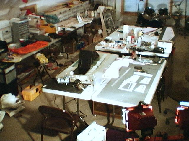

My dad thinks I've just gone nuts with the airplanes because of my workshop. As you can see, it's not fully painted, and it's not carpeted. When I got the drum set for my kid and myself a couple of months ago, I had to get something to dampen the sound, so I bought a 6x9 carpet pad and that helped. At a Home Depot I found an indoor/outdoor carpet remnant in 12' x 9' for $28 which was perfect for the space between the work tables on the drum end. Then at another Home Depot I found an end of roll remnant that was 12' x 22' in the same color for $58. So now it's sort of carpeted.
