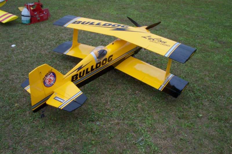

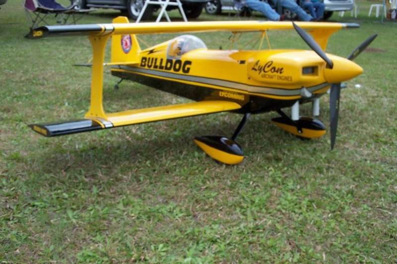

I finally finished my modified Weeks Solution X wtih BME 110. I put four more flights on it today with smoke what a nice flying plane. More pics and video on my website.
http://hometown.aol.com/bike466/index.html
