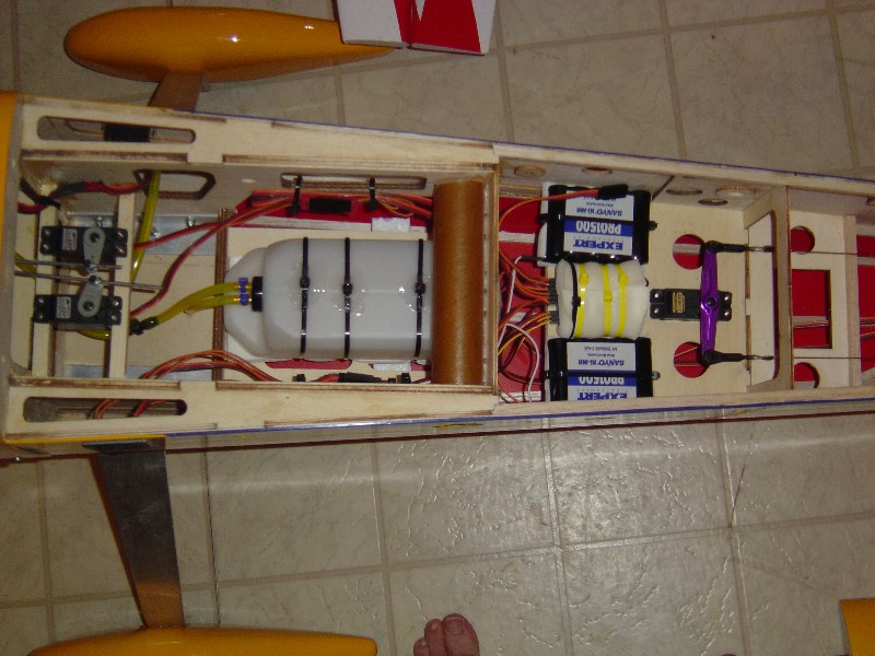

Engine - Myself and a friend both have DA50's in our 28% Edges and are more than happy with the performance. I'm sure they're all pretty comparable and all good engines, I chose DA because I heard their customer service is outstanding and through my few dealings with them I have found that to be true. He is running a 22x8 Menz and I'm running a 22x8 MSC, both hover and less than 1/2 and pull out with authority... havent weighed them on an accurate scale but bathroom scales say about 17lbs so I'm figuring around 17-18.
Radio gear - I'm running 5945's on everything but the rudder, which is a single 8611, a 5245MG on the throttle and a standard ball bearing Airtronics (922Z?) on the choke, this seems to be an excellent setup in my opinion. Batteries are 2 Radical RC 6v 2150mah NiMH's into one receiver through two Hitec heavy duty switches (friend has Fromeco batteries and switches in his, the style you want... they seem very nice) and one of the same 2150mah's on the ignition @ 6v.

The in-flight pics are a bit blurry but are from the maiden flight this last Friday lol.

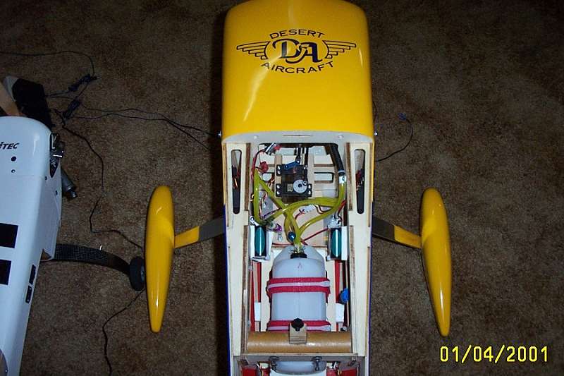

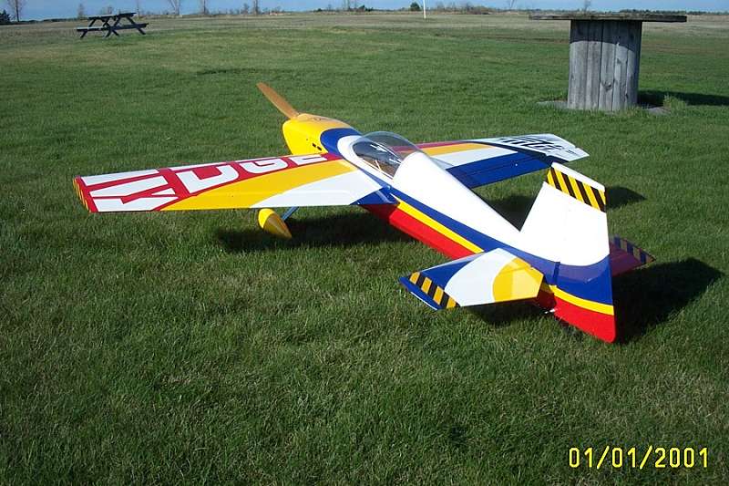

Just finished building mine with a DA50, balanced at 4-1/2 right off the bat. Put my batteries and receiver right in front of the rudder servo and it was right at the 5" mark.
Maiden in a couple of weeks, can't wait.

The install you have there looks really nice. Are both those battery pack feeding reciever or are they split between the servos and reciever?

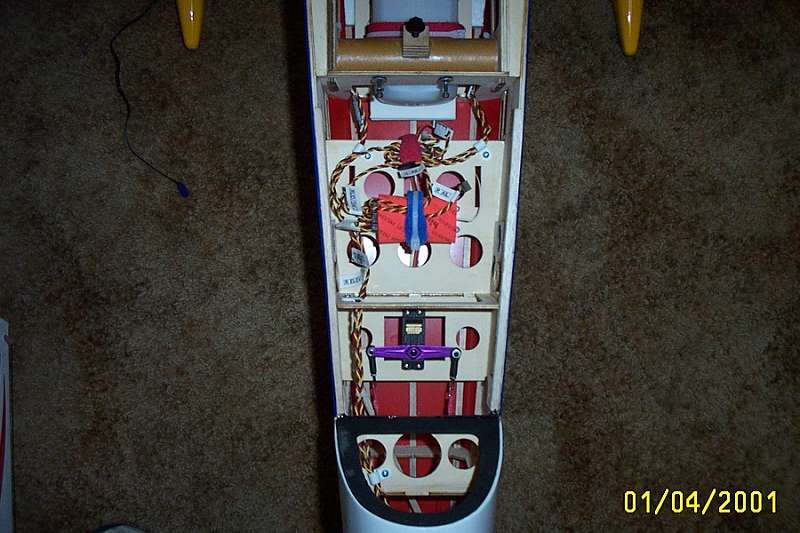

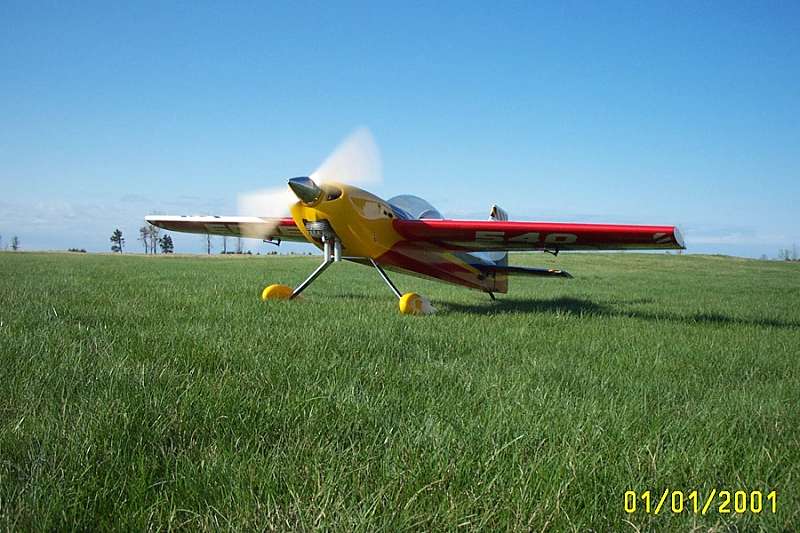

Warbirds - I see I cant pull one over on you, can I... LOL j/k Your bird looks good too!
Here's a couple pics of the guts of mine for more setup ideas... this balances @ 5" exactly with DA50 and a big Dave Brown Ultimate style spinner hangin off the front.
Thanks. They are both feeding the receiver.
