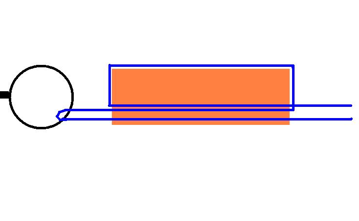

Here is a pic of how to crimp the cables.
Run the cable through the little brass tube. Now pass it through the eye of the bolt or keeper on the bellcrank. Run it back through the brass tube. Now wrap it up and around the top of the brass tube and back through the tube one more time.
Cinch the wires up and get them all as tight as possible before you crimp. See second and third pics.
To crimp, simply squeeze the hell out of it with a pair of pliers. It should smash down a bit. That will crimp the tube nicely on the wire cables. Never had one come out.

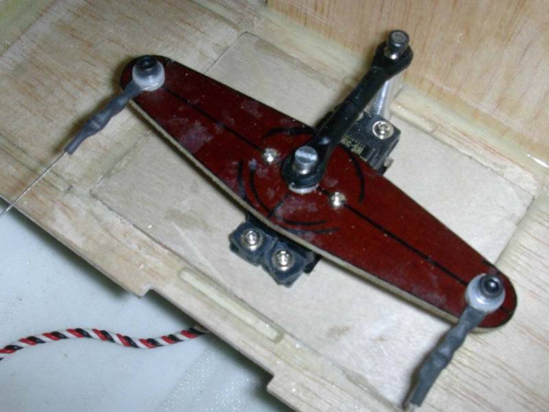

I wouldn't do it like that. That places a tremendous side load on your servo bearings and output shaft.
That's where you'd be better off to use a bellcrank. The bellcrank takes all the side load. The bellcrank has bearings that are twice as big as your servo bearings, so it can handle the loads. And bellcranks are cheaper than servos if you wear it out.

To diminish tremendous side load in the servo bearings. "A lo BVM style"
BR
Jesus
