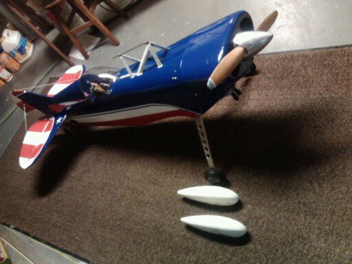

Yea here's a picture of one I built with a Saito 300, liked it so much that I've built another that will have the gasser engine.
I'm thinking of fabricating a mounting cage similar to whats on this Saito only out of alluminum.

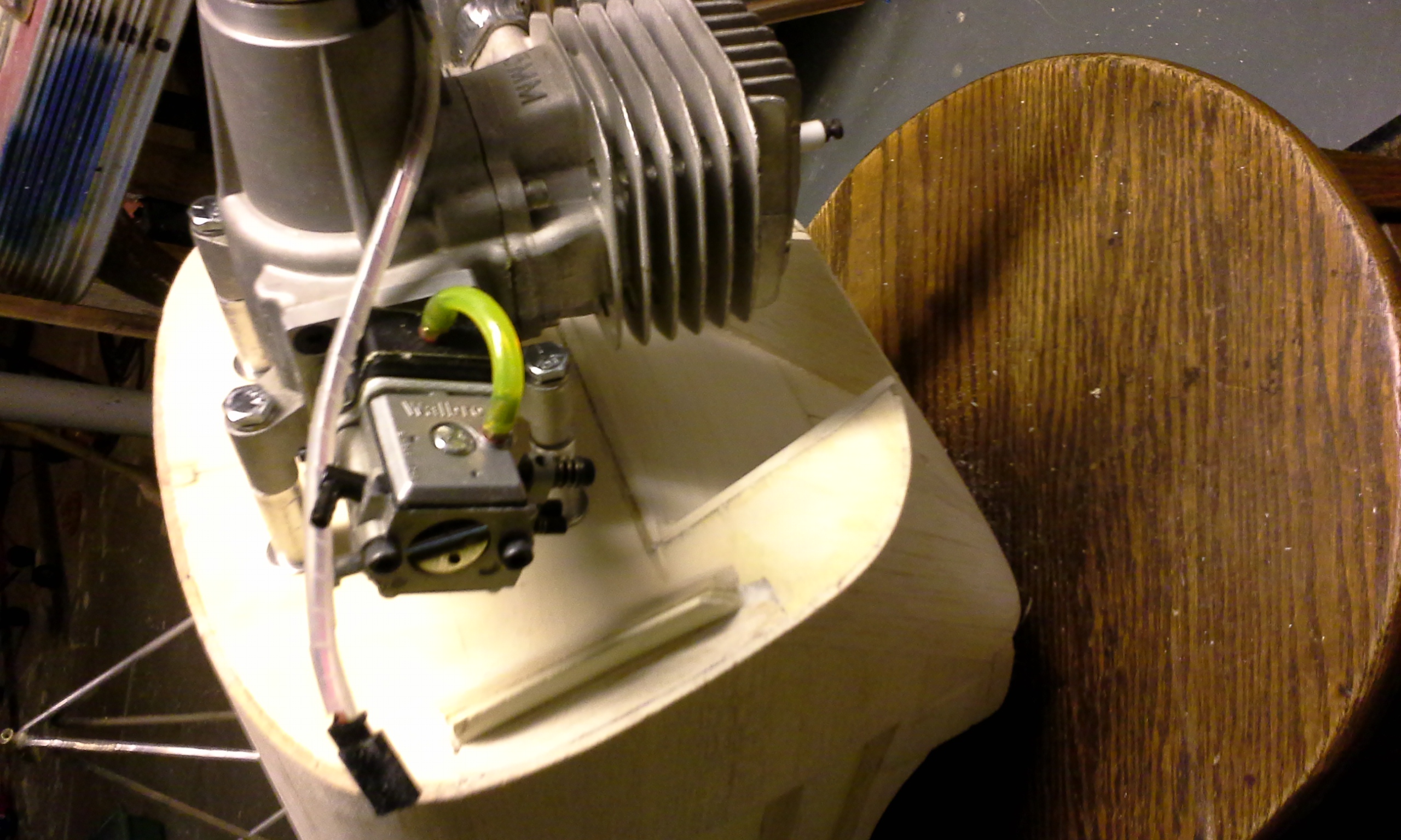

To answer your question. No you do not an engine box for cooling. It was devised as a way to allow various engines to be used on a single design. Miles designed that plane for the avaiable engines, at the time. If youe engine fits the cowling mounted on the firewall, great. Some builders move the firewall to accomodatre engine of choice. Stand offs and boxes can also be used if you need to extend the engine out to match the cowl. Just make sure it as strong and secure.

Thank you, Planning to provide enough space for air circulate through and out, probably no need to build a box, it's a 3/8 firewall laminated from three 1/8" pieces of aircraft ply.

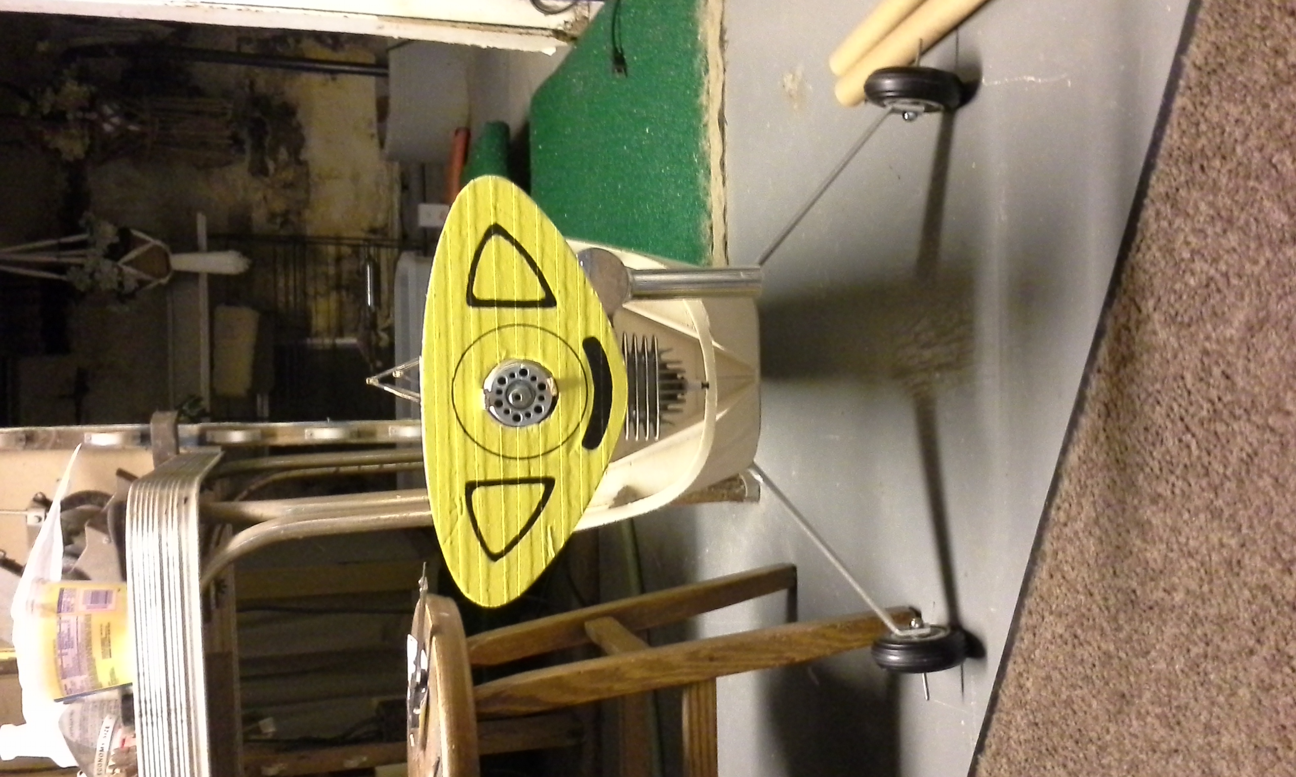

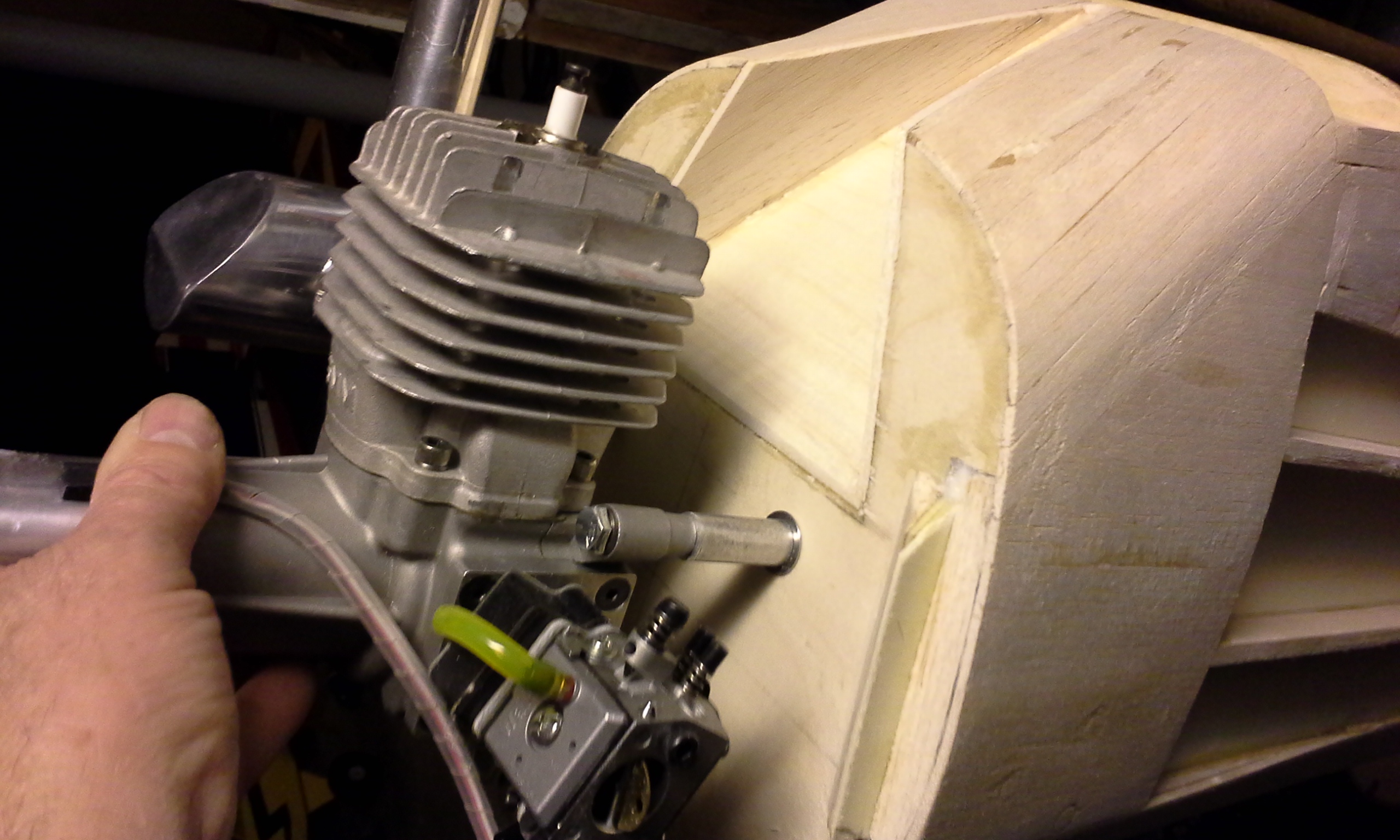

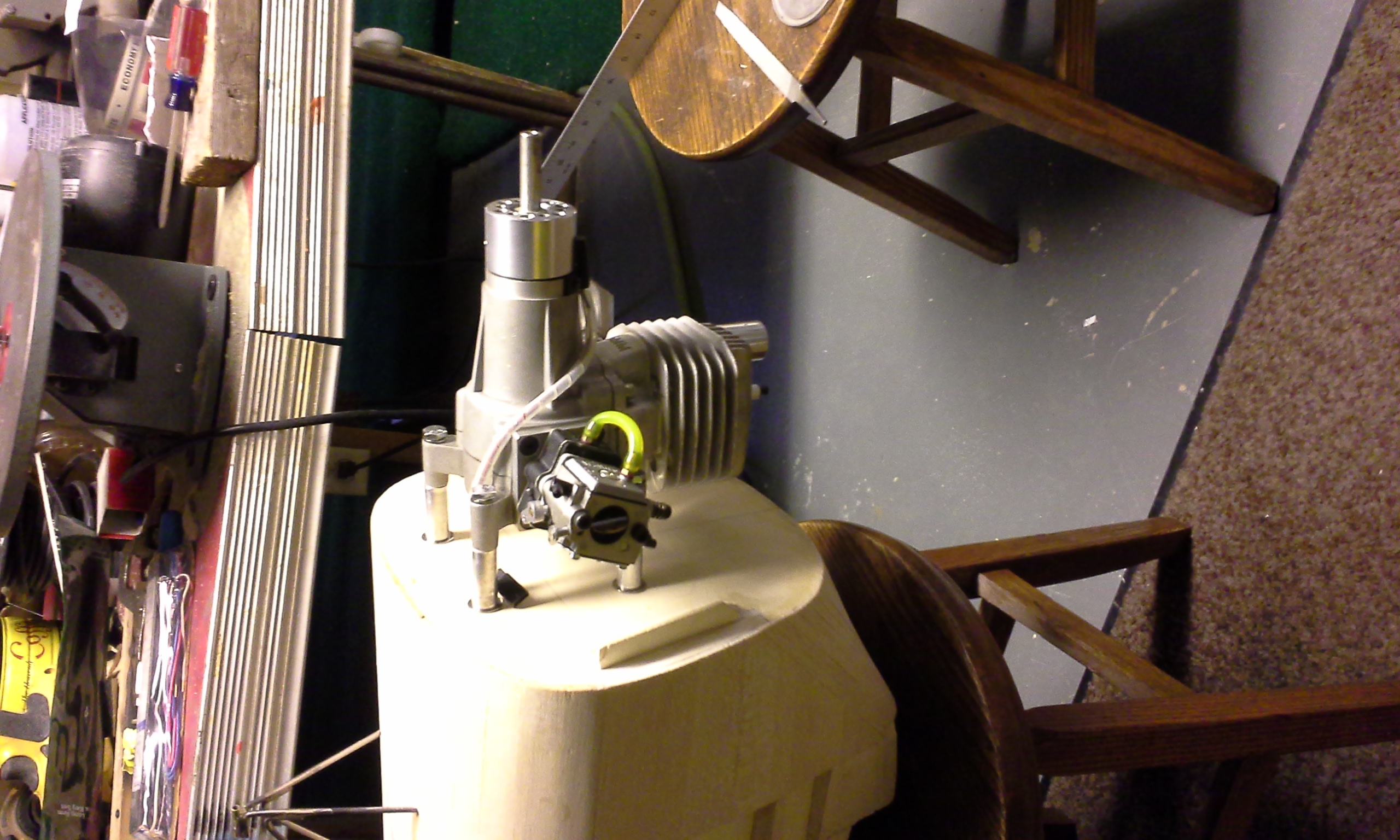

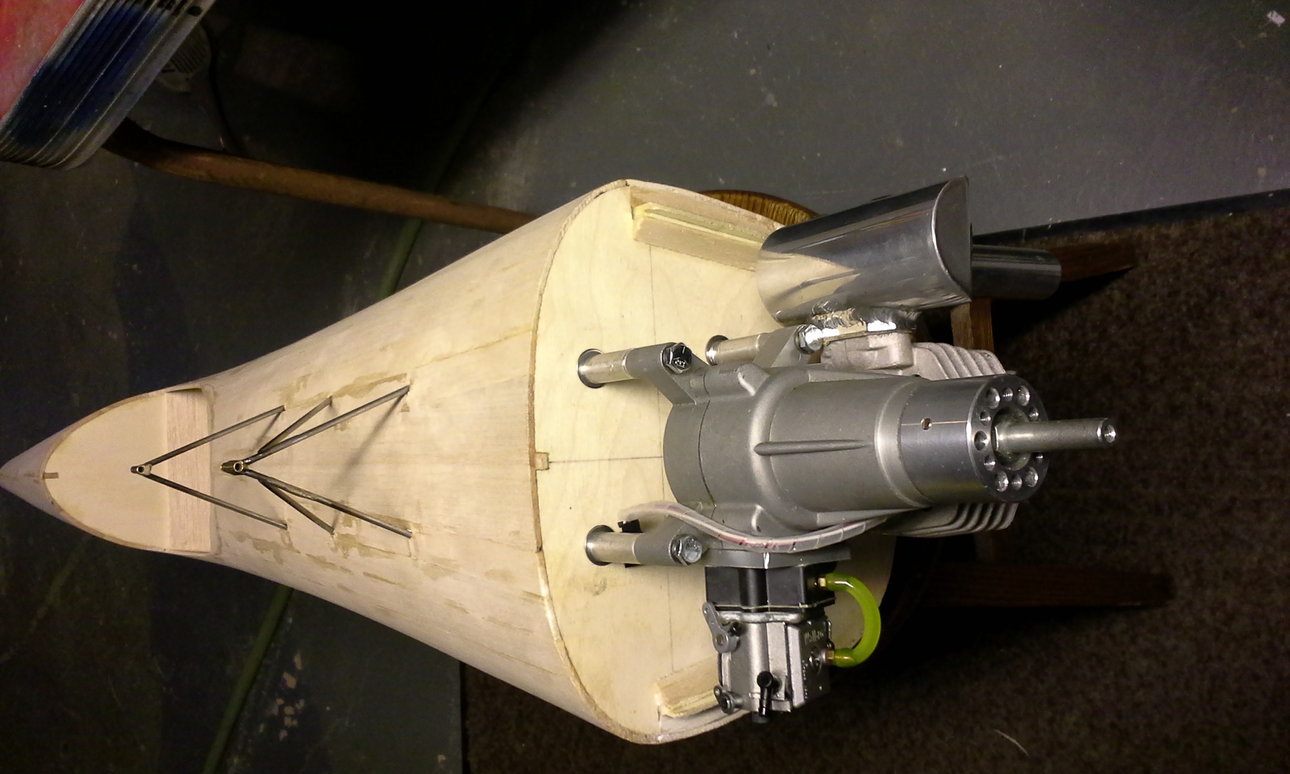

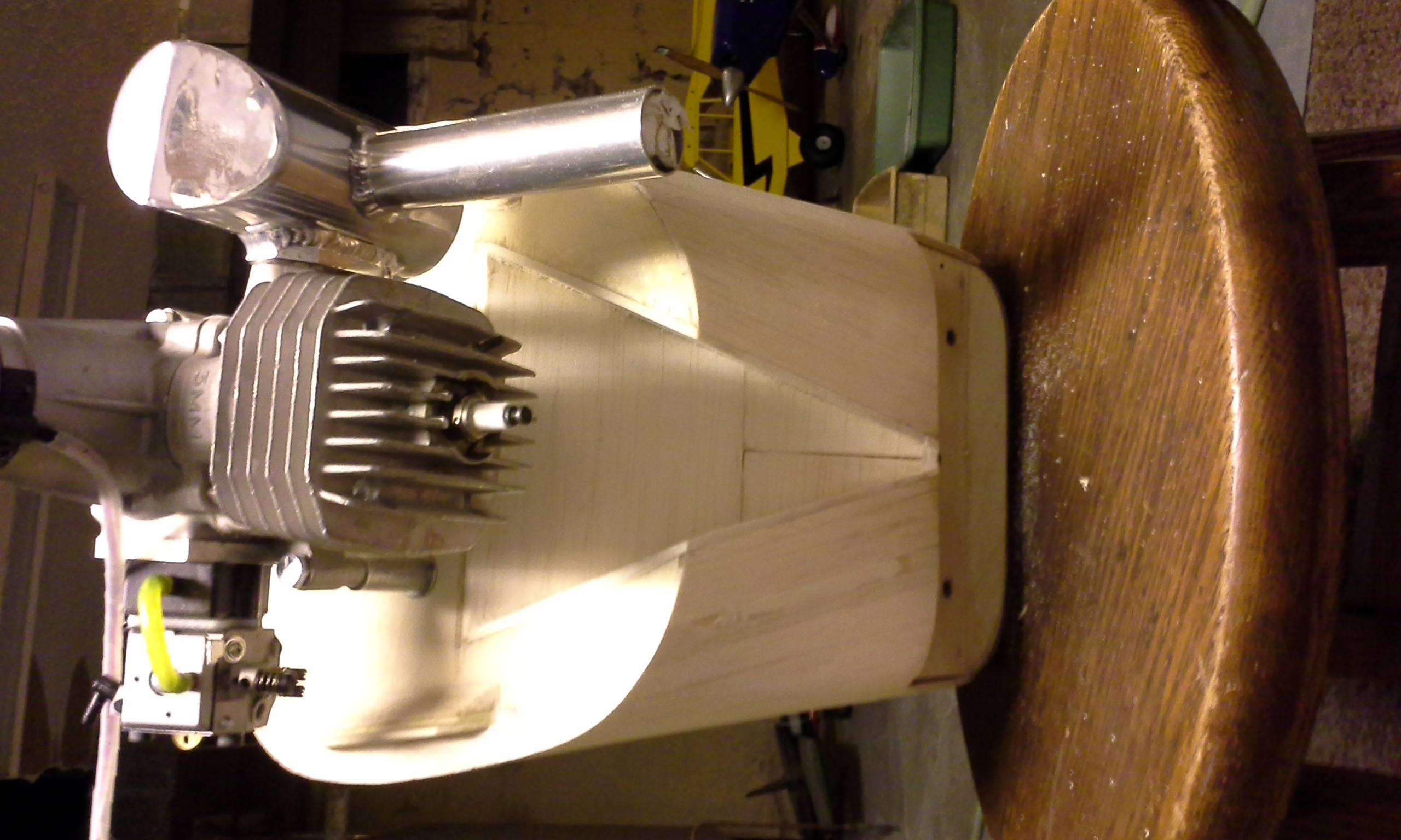

I've adjusted the firewall to provide a little air runoff, the last thing I want to do is cook this engine from lack of airflow around the fins, still not sure how I'm going to bring freah air into the cowl, I painted some of the areas to be cut out but don't like the position. Give me your ideas please.
